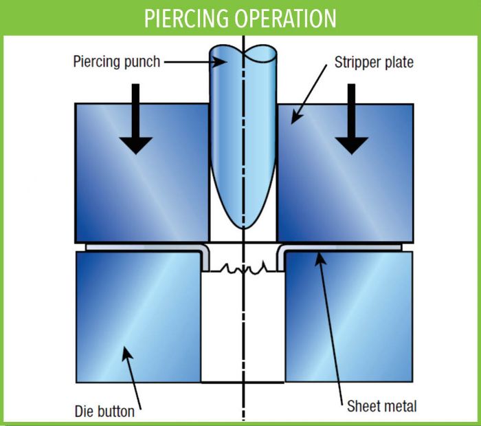

Another source of confusion involves the terminology used for making holes. Are they punched or pierced? To differentiate between punching and piercing, consider that punching operations produce slugs while piercing operations do not. Or, consider that piercing a steak with your fork does not produce a slug, nor does ear piercing.
Piercing operations frequently are defined as “forming a hole in sheet metal with a pointed punch with no metal fallout.” The figure depicts a piercing operation fitting this description.
