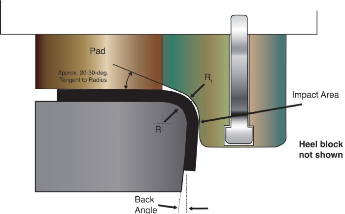

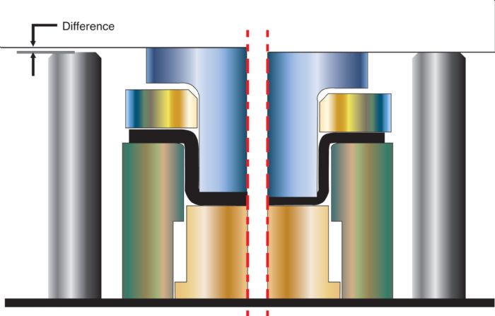

Springback Compensation
A correctly set die shut height for the material thickness being formed needs no additional adjustments. Far too often, technicians will alter die shut height to compensate for die-timing issues, such as a stencil hitting too hard or a bent flange that is sprung-open or overbent.
