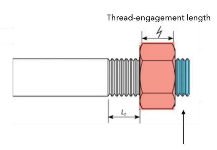

When using the bolt and T-nut arrangement, select a bolt that enters the T-nut threads equivalent to the bolt diameter, at minimum. That is, if the bolt diameter measures ¾ in., then the bolt threads must enter into the T-nut threads at least ¾ in. The preferred engagement is 1.5 times the bolt diameter. The proper-length bolt will require no more than two washers, with the bolt threads not extending beyond the bottom of the T-nut. Ensure that the selected bolts or studs are straight and that the threads are not damaged. To avoid wrench slippage, ensure that the hex head does not have rounded corners.

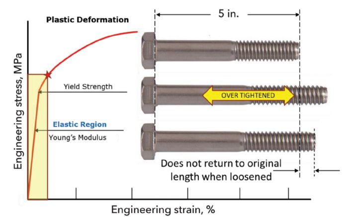

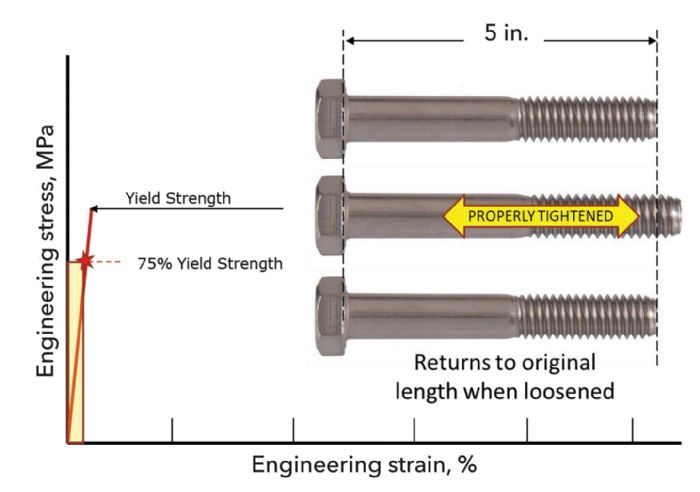

The materials being fastened compress slightly under this force, enhancing the friction between them and resisting slippage or separation. The bolt threads allow for gradual tightening, enabling precise control over the amount of stretch (tension). Fasteners for die setting perform optimally when tightened to approximately 75% of their yield stress.
