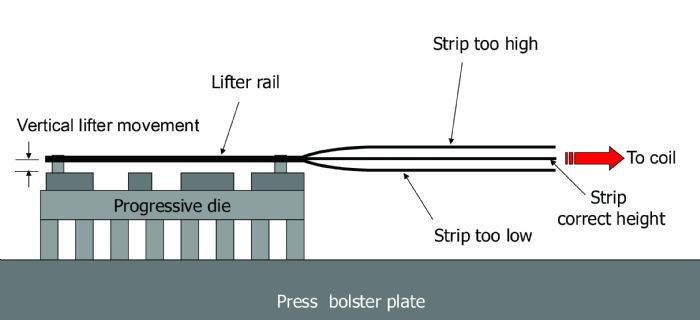

Progressive set up part 2 illust SOF  1Passline height, also known as feedline height, is the height at which the coil material feeds into the die. Ideally, stampers set passline height to the same height as the strip lifter system when in its idle or up position. Avoid feeding downward or upward into the tool. Regardless of the strip’s vertical travel, take care to set passline height at the level at which the material enters. Setting passline height at the midpoint of the strip’s vertical travel most likely is an attempt to compensate for an incorrect pilot-release setup.
Correctly setting passline height helps keep the material straight and flat. Straight, flat material is stiff and less likely to buckle or fold onto itself during coil feeding (Fig. 1).

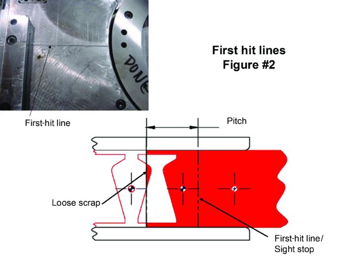

Progressive set up part 2 illust SOF  2Starting the material at the wrong point in the tool can result in half hits, half cuts and half forms. This may result in severe unbalanced forces within the die, which can cause severe tool damage.
When threading the die, take care to properly feed up to the correct strip-starting position in the die—often called the first-hit line. It can be a solid stop such as a pin or pitch stop block, or it might be a simple line drawn, ground, or scribed on the die.
After the die has completed its first cycle, inspect the lower and upper die sections for loose scrap. Many dies produce small pieces of “startup scrap” produced during the strip-starting process. These small pieces of scrap tend to stick to the faces of cutting punches, pads and strippers. Failing to remove loose scrap from the die will result in the material being doubly thick, which also can result in die damage (Fig. 2).
Many die designers prefer to build in a solid stop as the first hit point. This represents good engineering practice, as it helps to eliminate misinterpretation of the material feed point. It also prevents incorrect judgments regarding the actual accuracy of the point. In addition, this can prevent overfeeding of the material, which can result in die damage.

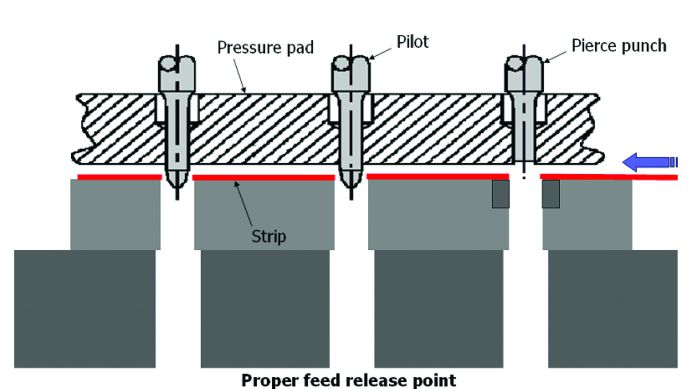

Pilot release, often referred to as feed release, is an important part of setting up a progressive die. The pilot-release function on a coil feeder releases the strip being fed into the die so that the pilots in the die can properly locate and register the strip in the die. Most coil feeders use feed rollers to index the material inward. These feed rollers clamp onto the strip and rotate a given amount, causing the strip to feed one progression forward. For the pilots to position the strip correctly, the feed rollers must unclamp the strip before full pilot entry. However, letting go of the material too soon—before the pilots partially enter the strip—can pull the strip out of position by the weight of the takeup loop between the feeder and the coil.
Progressive set up part 2 illust SOF  3The feed release must be timed so that the bullet nose of the pilot enters the strip, but the full pilot diameter does not. To determine this point, inch the press downward until the very tips of the pilots begin to enter the strip. Once you’ve established this point, note the degrees on the press stroke and set the pilot release to let go of the strip at this point. Program or adjust the pilot release so that the material or strip remains fully unclamped (feed rollers in the open position) until all of the work has been performed in the die and the strip has been returned to the proper feeding level (Fig. 3).
With the strip at feeding level, the feed rollers can clamp the strip and feed it forward one progression. Again, monitor this point during the press stroke and adjust the feed release with respect to the degrees during the crank stroke. Doing so correctly allows the material to move linearly inward and away from the die during the vertical travel of the lifter bars. Incorrect setup of the feed release can cause misfeed; elongation of the pilot holes in the strip; bent, broken or galled pilots; and poor part location and gauging.
