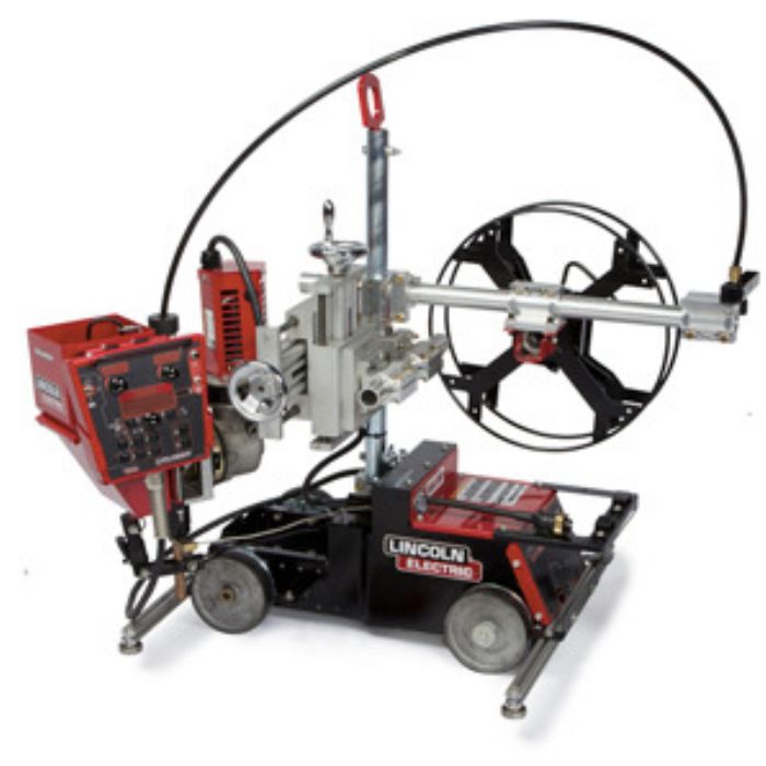

Submerged-arc welding (SAW) uses a continuously fed wire with a flux to cover the weld area. This type of welding finds use primarily on heavier-plate applications such as structural steel and on specialized, high-speed welding of light sections.
The flux plays a central role in achieving high speed and quality welds. SAW produces little welding fume, leaving much cleaner shop air that other processes. Because flux covers the entire arc, SAW does not require a welding helmet, leading to a higher operating factor. In fact, on long, large welds, and on multipass and overlay applications, the process can approach a 100-percent operating factor, with welding currents exceeding 1000 A common on automatic applications.
Disadvantages include limited welding positions, because flux comes in granular form. Operators must weld on flat surfaces to assure that the flux covers the weld puddle. Another disadvantage: Hot flux can burn shoes and cause handling problems.
