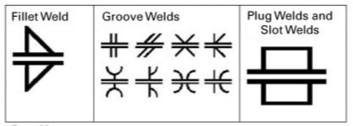

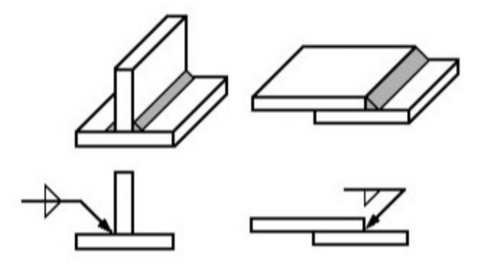

Each welding position has its own basic symbol, typically placed near the center of the reference line (and above or below it, depending on the side of the joint to which it applies). The symbol, a small drawing, usually can be interpreted as a simplified cross-section of the weld (Fig. 4). Let’s look more closely to symbols related to fillet welds, plug welds and slot welds.
Fillet-Weld Symbols
The fillet weld is employed for lap, corner and T joints. As its symbol suggests, the fillet weld is roughly triangular in cross-section, although its shape is not always a right or an isosceles triangle. Weld metal is deposited in a corner formed by the fitup of the two members and penetrates and fuses with the base metal to form the joint.

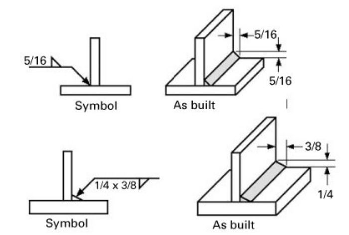

The perpendicular leg of the triangle always is drawn on the left side of the symbol, regardless of the orientation of the weld itself (Fig. 5). The leg size is written to the left of the weld symbol. If the two legs of the weld are to be the same size, only one dimension is given; if the weld is to have unequal legs (much less common than the equal-legged weld), both dimensions are given along with an indication on the drawing as to which leg is longer (Fig. 6).

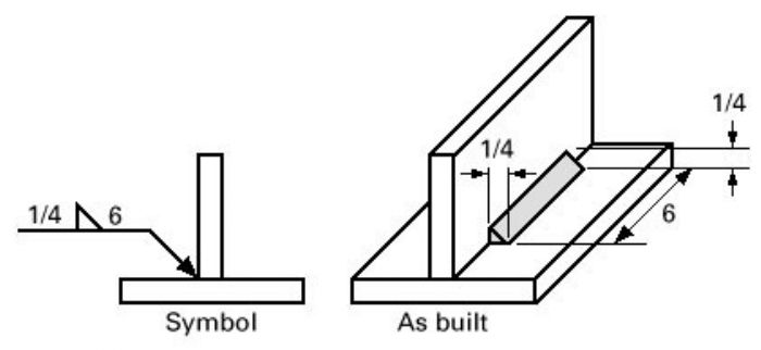

The length of the weld is given to the right of the symbol (Fig. 7).
If no length is given, then the weld is to be placed between specified dimension lines (if given) or between those points where an abrupt change in the weld direction would occur, such as at the end of the plates as shown in Fig. 7.

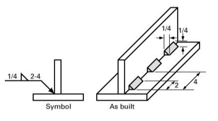

For intermittent welds, the length of each portion of the weld and the spacing of the welds are separated by a dash (length first, spacing second) and placed to the right of the fillet-weld symbol (Fig. 8). Notice that the spacing, or pitch, does not denote the clear space between the welds, but rather the center-to-center (or end-to-end) distance.

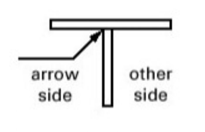

For plug welds (Fig. 9), the diameter of each plug is given to the left of the symbol, with the plug-to-plug spacing (pitch) provided to the right. For slot welds, the width of each slot is given to the left of the symbol, with the length and pitch (separated by a dash) provided to the right. A detail drawing is referenced in the tail. Parentheses located above or below the weld symbol contain the number of plugs or slots. The arrow-side and other-side designations indicate which piece contains the hole(s). If the hole should not be filled completely with weld metal, the depth to which it should be filled is provided within the weld symbol.
