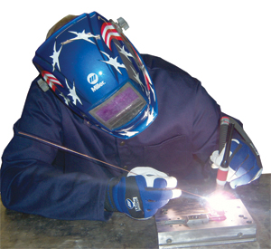

 Weld-Repair of Tooling: Proceed with Caution
Repairing metal-stamping dies and tooling using gas-tungsten-arc welding requires extraordinary manual dexterity, attention to detail and an understanding of metallurgy that goes beyond most other welding applications. Even then, success is not guaranteed.
Here are some tips to help ensure success.
  • Cleanliness is critical. Be sure to clean within 5 in. of the area to be welded using an acetone cleaner, or by burning off any plastic or silicone residue with a preheating device.
  • Use a DC inverter-based welding machine, which will provide optimum low-amperage arc stability and control. An air-cooled torch rated at 50 A will provide the best maneuverability.
  • Also use a gas lens—gas lenses smooth out the shielding-gas flow, greatly reducing the possibility of weld defects due to exposure to the air. Some newer gas lenses feature a single filter that also provides improved gas-flow regulation compared to older-style lenses with as many as five layers of screens. Gas lenses also allow for greater tungsten stick-out, which can provide better access to tight joint configurations.
  • Select 2 percent ceriated tungsten to provide optimum low-amperage arc starts. A small-diameter electrode, 0.040-in. or 1⁄16-in., will do the best job of keeping the heat restricted to the area on the die that needs to be welded.
  • Use a smooth, pointed tungsten to provide optimum arc control. Also, wear an auto-darkening welding helmet with a shade-9 or lighter lens to ensure accurate arc starts and arc visibility.
  • Because the base material has been hardened and tempered, selecting the optimum filler material should only be done with the assistance of a reference manual or by consulting with a welding distributor or filler-metal manufacturer.
  • Instead of dipping the filler metal into the weld pool, keep the filler metal in the pool while welding, being careful to insert the minimum amount of filler metal necessary.
  • To avoid creating stresses in the tool or die that could lead to future cracking, the workpiece should be kept at a temperature specified by a reference guide before and during welding, and brought back to room temperature gradually.

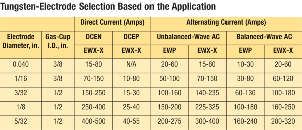

Tungsten Selection
Tungsten alloys are not created equal. When welding at low amperages, select a 2 percent ceriated tungsten. This electrode type provides good arc starting at low amperages, and can be used for AC and DC welding of carbon or stainless steels, nickel, aluminum and titanium alloys. The same is true for 1.5 percent lanthanated tungsten electrodes.
For higher-current applications or for low-amperage AC applications, a 2 percent thoriated tungsten electrode provides good arc starting. Note: Thorium is radioactive, so welders must follow manufacturer’s warnings, instructions and the Material Safety Data Sheet for its use. MF
