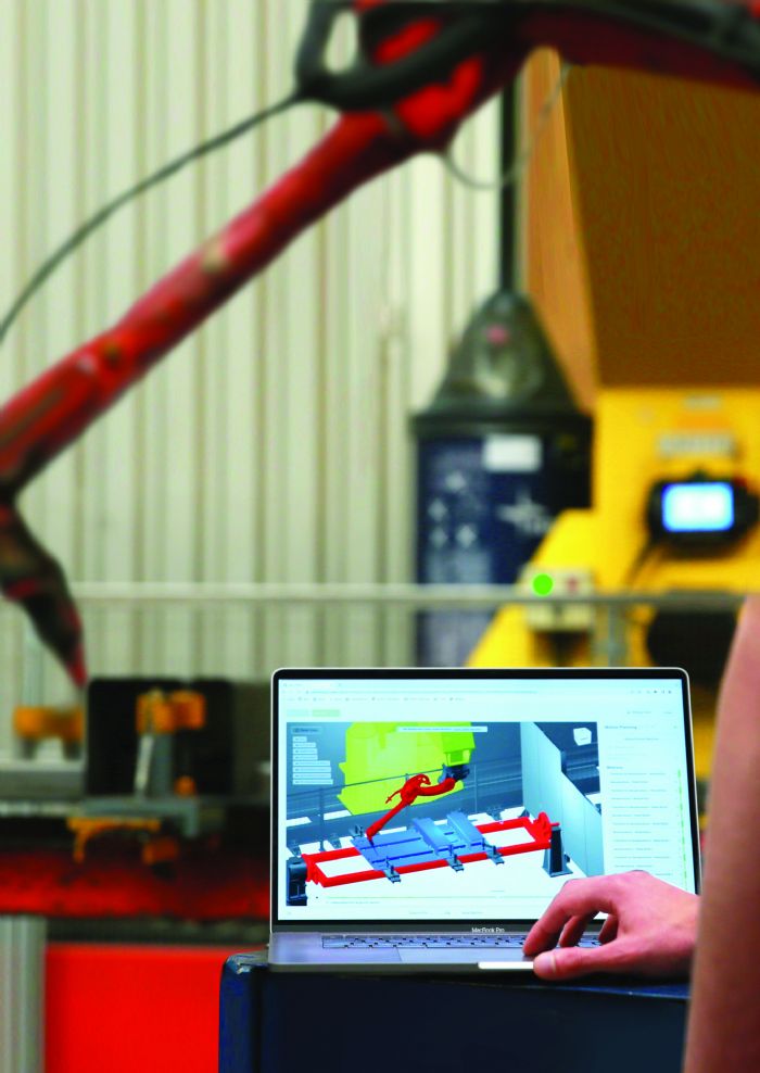

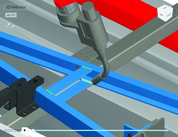

“In practice, after a user uploads a CAD file, the software for welding extracts potential weld lines, generates collision-free robot-motion profiles and suggests optimal welding-process parameters using AI and machine learning technology,” says Mark Forth, general manager of industrial manufacturing for Oqton.
The software uses tactile sense motions to recognize and adjust for geometric deviations and mounting errors. Users, if desired, can make adjustments through a simple, intuitive user interface that is built for welders, and does not require programming knowledge. Once the robot begins welding, Oqton IoT monitors the process quality online, with real-time alerts and reports for manual inspection or rework generated automatically.

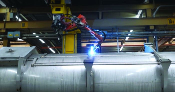

Since the Oqton collaboration began in 2021, Van Hool has made significant improvement in robotic welding operations. Where one operator was needed per robot for small-volume work, according to Ceulemans, now a single operator can cover several robots. And, offline programming of robots enables the virtual perfection of all movements, from the start of a weld to its conclusion, before passing of these movements to the robots, with no manufacturing downtime.
“When using offline programming for robotic welding before employing the software, we first needed to determine the exact location of each individual weld,” says Ceulemans. “And, we had to enter all of the movements, from the start of a weld to the conclusion of a weld, to avoid collisions. With the new software, we only need to determine the type of weld and fine-tune the weld while the software handles movements to and from the weld. In the past, while programming the robot welding we would focus on programming the robot,” he continues. “Now we can focus mainly on the welding.”
