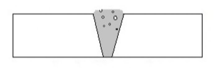

Porosity
Porosity occurs when gas pores become trapped in the solid weld bead. They result from the absorption of gas into the molten weld pool. The gas pores can vary in size, can be distributed uniformly or in a random manner, and can be found on the weld surface or at the center of the bead.
Weld pores often are caused by the atmospheric gases nitrogen and oxygen contaminating the weld, due to insufficient gas shielding.
To troubleshoot porosity:
- Check for sufficient shielding-gas flow. Inspect the gas hoses and welding gun for leaks.
- Ensure that the nozzle isn’t clogged and restricting gas flow.
- If welding outdoors, avoid windy conditions that can interfere with the shielding gas.
- Verify proper gas flow using the regulator or flow meter. Too little or too much shielding gas can cause porosity.
Porosity also can originate from hydrogen and oxygen on a contaminated workpiece, such as oxidized metal or moisture on the workpiece. In these cases:
- Thoroughly remove any oxide film from the workpiece surface.
- Ensure that the workpiece and welding electrode are completely dry before welding.
- Use a filler metal containing deoxidants.
