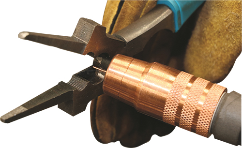

Ever wonder why whelpers are 1⁄2 in. thick? It’s to help cut the wire to a length that promotes good arc starts.

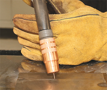

Operators need to ask fundamental questions such as, “Why are gun angle and travel direction so critical?”

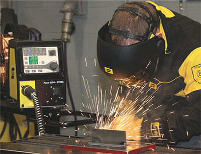

With a shortage of skilled welders, companies benefit from advanced GMAW systems with preset programs for welding with various processes, synergic controls and smart GMAW functions.
Delving deeper, the application engineers noted that, beyond personal preferences, too many operators don’t know why they should push or drag the gun in a given solid-wire application, nor do they ask why gun angle is so critical. For the record:
  • Pushing directs arc force away from the puddle to produce a wider and flatter bead with less penetration.
  • Dragging directs arc force at the puddle to produce deeper penetration and a narrower bead with more buildup.
  • Achieving a gun angle (or angle of travel) of 5 to 15 deg. from perpendicular is required in most situations.
  • Seeking recommendations for specific applications from filler-metal manufacturers is better than seeking advice from online bulletin boards that may contain inaccuracies.
“The problem is that people practice with poor mechanics, and practicing wrong isn’t going to make you a better welder,” said Lott. “They use too much gun angle and don’t realize it increases arc instability and spatter, much less realize they’re losing penetration.”
