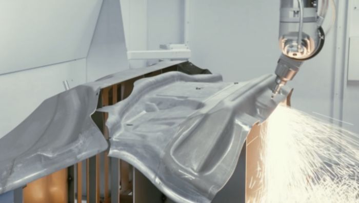

ArcelorMittal-Trumpf-laser-welded-blanks-automotive-MPI-weldingA collaboration between steelmaker ArcelorMittal and Trumpf has enabled Trumpf’s five-axis laser cutting machines to integrate seamlessly with ArcelorMittal’s Multi Part Integration (MPI) solutions that streamline vehicle design by combining multiple vehicle components into a single laser-welded blank (LWB), according to officials from the steelmaker. Employing such cutting allows for precise shaping of laser-welded, hot-stamped MPI parts for modern vehicle design. The collaboration involves laser cutting with Usibor and Ductibor, ArcelorMittal’s steels ideal for hot stamping.
Trumpf’s noncontact laser cutting process ensures burr-free edges and minimal waste, while reducing production line wear, cite ArcelorMittal officials while noting that such capabilities enhance the performance of MPI regimens that produce massive components integral to vehicle design where accuracy in shape and form is critical to ensure seamless integration and optimal performance.
At the core of this collaboration: sustainability. By reducing material waste and optimizing production processes, laser cutting technology can streamline manufacturing and align with the automotive industry’s growing demand for environmentally friendly practices. And, officials point out, the noncontact nature of laser cutting ensures minimal wear on equipment, further enhancing the sustainability and efficiency of production lines.
