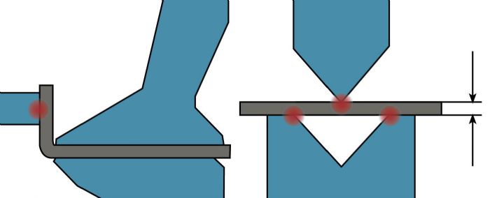

Folding machines clamp the workpiece in a stationary position, and a blade or wing bends the flange. This creates a bend between a fulcrum and a leverage point. With only two points of contact, the radius pitch can be as small as 0.001 in.
Segments_stockOn a press brake, the workpiece slides across three points of contact—the punch-nose radius, and the two shoulder radii of the die opening. The bend’s elongation occurs between the die’s shoulder radii—half in front of the punch’s contact point and half behind. The minimum-radius pitch must be half of the width of the die opening to bridge the gap. This creates a chopped appearance—certainly not an optimal method to achieve a smooth bend, but some simple workarounds can help.

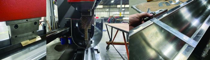

A second method to attain a smooth radius on the second and subsequent bends is to use a strip of urethane to take up the volume of the die, avoiding falling into the die entirely. The urethane removes the die width from the equation as the workpiece will be supported continually throughout the bending cycle. This reduces the minimum-radius pitch to 0.001 in., though the elongation still occurs on both sides of the punch. Notably, this method works well to 12-gauge thickness; with thicker work, the urethane takes a beating.

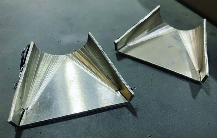

Formed-with-a-normal-angleA third approach is bending without a press brake. Folding often gets the call for step bending because the fulcrum keeps the part clamped and supported throughout the entire forming process. Reinserting an out-of-tolerance, step-bent part on a folder for rework is not really an option because of the clamping beams. But the concept can be applied when reworking a part slightly out of tolerance outside of a machine, be it a folder or a press brake. If the part is overbent, the operator need only clamp the part down to a worktable and hand-form it open. Working a part open is much easier than fighting to work the part to a more acute angle.

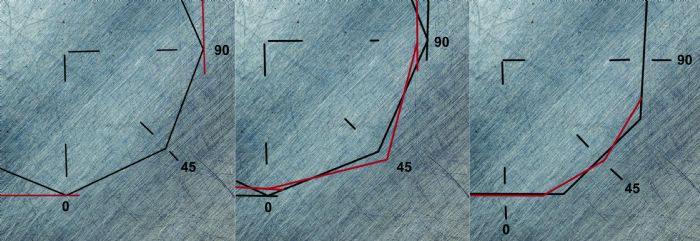

Layout on a press brake is not as straightforward as it is on a folder. If the operator starts and ends bends using the bend allowance as the arc length, the radius will be too large. This occurs, in part, because in the brake, the material forms between three points of contact, with the punch being a pushing rod in the center. The elongation that occurs in front of the bend line will grow the radius beyond the anticipated start and end points. This overshoot will result in a longer arc length, manifesting in either an overbent angle or an enlarged radius.

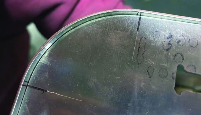

This leads to another variable that affects press brakes and folders—segments. Using a gauge cut to the inside radius reveals areas of the bend that may be too tight or loose. A truly smooth radius will match an inside template perfectly. However, a segment will prevent the radius of an inside template from reaching its correct depth. The larger the segments, the more the interference.
Stainless-Steel-U-ShapeOften, operators account for the elongation overshoot and segment interference by cheating the angle of the start and end points. Making these two outermost bends at half of the angle of the interior bends may work reasonably well but produces a slightly parabolic shape. Moving the start and end points of the arc length inward by half of the radius pitch renders a better result. This will rotate the interference point of the segments to the desired start and end of the bend’s arc.

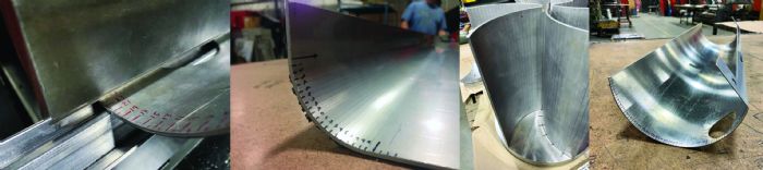

Preventing canoeing is essential to achieving a straight, post-formed part. Step bending tends to magnify errors. A 0.5-deg. difference per bend will accumulate to a 5-deg. difference after performing only 10 bends. However, this may break stride with lean manufacturing rules; using test strips from the drop of the sheet will help ease any sheet-to-sheet variance. Eliminating variability is necessary for a step bend. To do this, the operator performs a 90-deg. bend and checks squareness at multiple locations along the test piece. This provides the opportunity to make adjustments, with global crowning and localized shimming on the same material as the workpiece. Normal tolerance for sheet metal allows for more variation at the edges of the sheet compared to the center of the sheet. Therefore, the test material should be cut away from the sheet edge when possible.
Once the machine has been set up and adjusted, the operator forms the outer flanges and begins work on the U section. If the operator forms the U section from the center outward, the part will crash into the ram before completing all of the bends. Forming from the edges toward the center will ensure clearance between the workpiece and the machine. Care must be taken to verify that the radius is correct near the outer edges before moving toward the center. There will be no option to rehit these bends if the hits are too light.
Often, the operator gauges the workpiece by eye, aligning bend lines with a reference point. This can be anything stationary such as the punch nose, the die-shoulder radius, a marker line on the urethane or even a square blade set off the front of the die. This requires great operator skill to move the part by hand to an exacting dimension. They will form a few bends, then check the radius of the workpiece against a template. If the radius is too large, the operator adjusts the machine and rehits the workpiece until it falls within specification. If the radius is too small, the operator will need to either hand-work the part open or flip the part over and use a press to unbend the part slightly.
In trying to fix an inconsistent radius by hand, pulling open will lighten and pushing over will tighten, but where the part is held determines which area of the radius changes. Clamping the part down to a worktable, similar to how a folder works, will force the change to occur at a leverage point. Note: This radius manipulation also will affect the finished flange lengths.
