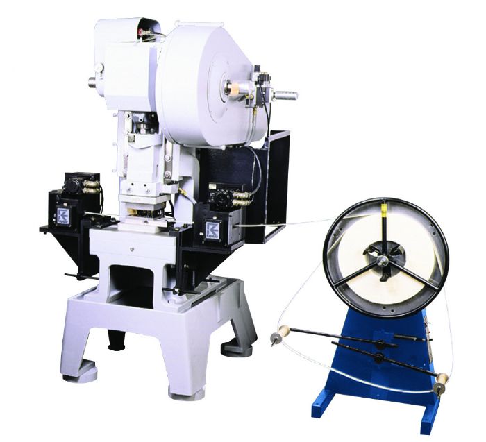

Air-operated reciprocating feeds, or air feeds with internal air circuitry, are actuated via mechanical, electric-solenoid or pneumatic valves. In all cases, the press should control the feed. To move material, an air feed grips its edge or clamps its full width.
Air feeds are engineered for accuracy and repeatability, featuring a the feed slide block that moves between two positive stops.
2. Why air? Why did your company pioneer this technology? What was lacking in the existing technologies?
1_airfeedsIn brief, company founder Richard Nordlof invented and pioneered the first air feed in the late 1950s. At that time, mechanical hitch feeds were the norm, but their accuracy and dependability were in question in many applications. While they were effective for many tasks, they lacked versatility. A company’s customer, Parker Pen, originally in Janesville, WI, sought a faster and more accurate feeding solution, which led to experimentation.
The air feed, small and compact, easily mounts to the press. Powered by air—requiring an air line with only 75 lb. of pressure—and the downward stroke of the press set to actuate the feed, it was an efficient machine. Although motors were in use at that time, the technology and controls available today were lacking. Times have changed, but the air feed remains a popular choice.

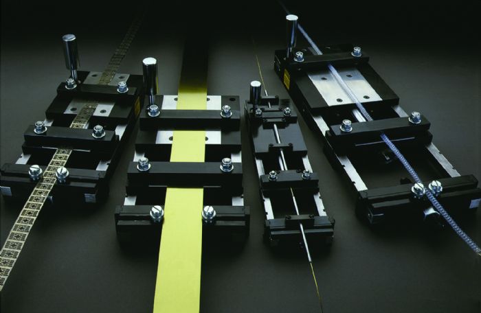

Versatile air feeds offer great flexibility when feeding various shapes because they can feed unusual shapes in unusual positions. Air feeds handle thin and delicate materials well. In addition, metal formers can feed various materials in any direction. An air feed potentially provide a large grip area with clamps.
Because it has a small envelope, an air feed can be mounted on the bolster plate or die to push or pull material through the die. Its low price tag often justifies permanent installation on die sets to minimize job-setup time. Die-mounted feeds facilitate quick changeover, reduced setup time and no required alignment of feed to die.

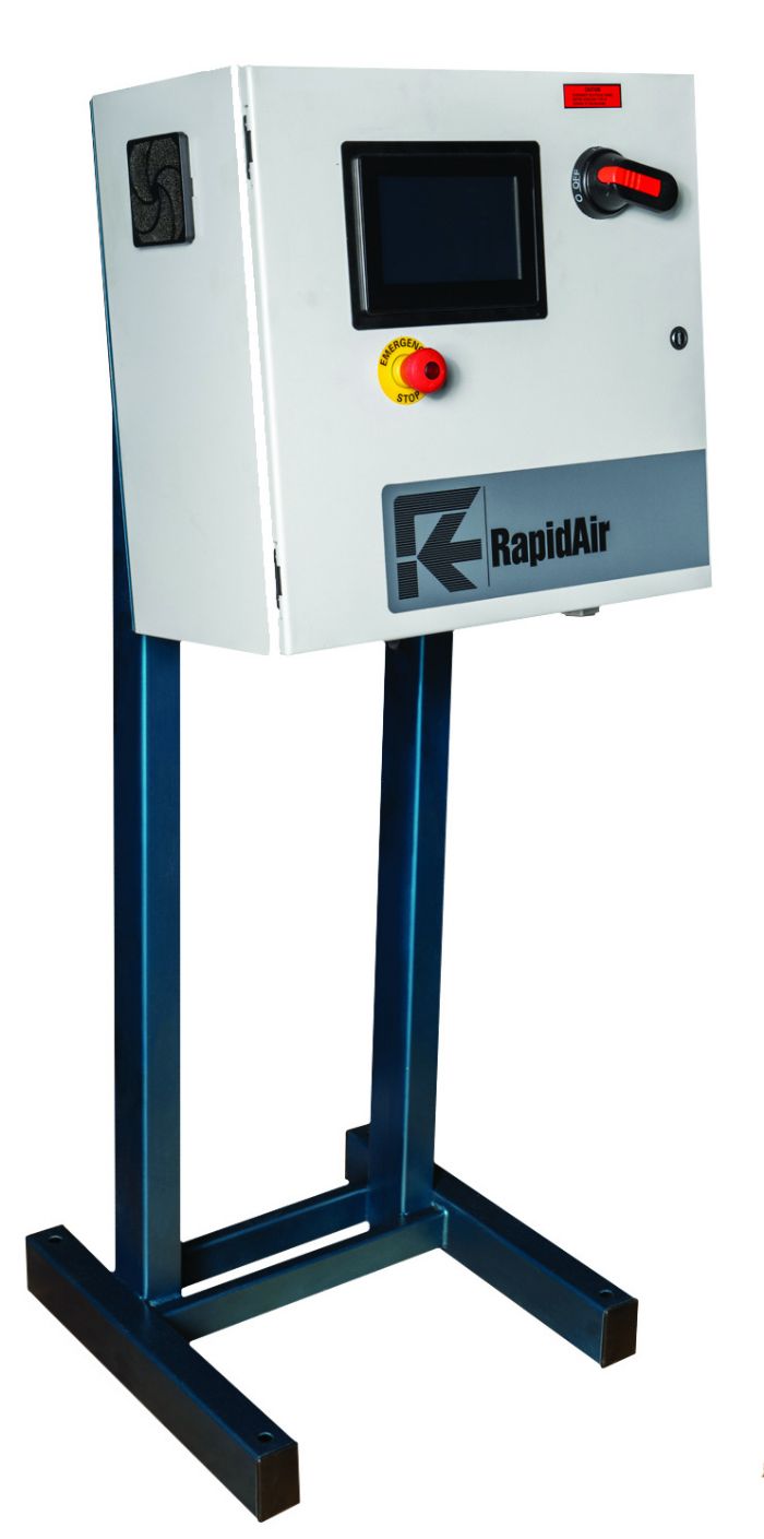

Servo controlA servo feed requires a higher initial capital expenditure than an air feed, generally quickly recovered with the increased productivity. It requires a programmable control box equipped with cables to the servo, power supply, press and possibly other components. The control box stores job memory and calculates feed progression, speed, acceleration and timing synchronization with the press.

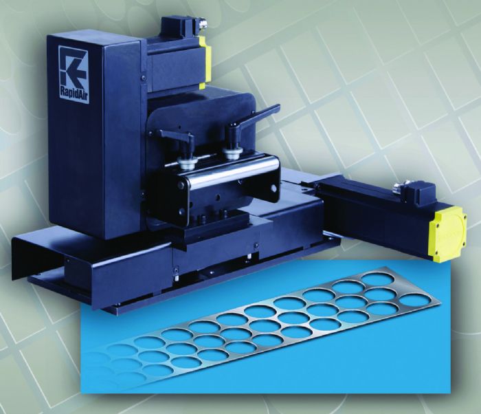

Servo stagger feed models are designed to help select the best pattern for round or non-round parts. This reduces material waste because it preprograms the optimal pattern and allows the use of irregular-width coil. Servo feeds with a gag program allow a pattern of changing feed lengths with outputs for punch control, and gag programs can be customized.
