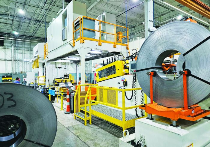

gasket frameThe TrimLine press lineup starts at 200 tons and peaks at 660 tons (prior to the coming addition). Its first two servo presses were 660-ton models, added in 2021 and 2022; 2023 welcomed a 440-ton servo. All are Aida models, outfitted with Dallas feedlines rated for coils to 30,000 lb. of material (48 in. wide on the 660-ton lines, 36 in. on the 440-ton line)—either cold- or hot-rolled mild steel, or aluminum sheet (Types 3003, 5052 or 5754), typically 0.060 in. thick.
Notable with its latest press line is the addition of feed-line automation, under the Dallas moniker AutoSet.  The automation, which fosters job-setup speed and repeatability, includes job-setup parameters for feeder passline height and edge guides, straightener break rolls and edge guides, coil guide rolls to enable automatic coil centering, and an automatically adjusting drag brake based on coil OD.
Also included: Allen-Bradley controls along with Dallas’ Sync-Loop and ProfileSelect options. SyncLoop technology, say Dallas officials, monitors average line speed and loop depth, and automatically adjusts payout speed to ensure a smooth payout. Loop-height setpoints store within each job recipe, providing highly tuned feed and loop control for each job.
The ProfileSelect feed control employs a sinusoidal (cam-motion) profile that results in a smooth feed motion utilizing 100% of the press-feed window. While servo-feed controls that employ a trapezoidal motion profile can create quick, jerky motions that may cause slippage, material damage and added stress to machine components, the sinusoidal profile results in smooth feeding that reduces stress on the material and the feed’s mechanical components.

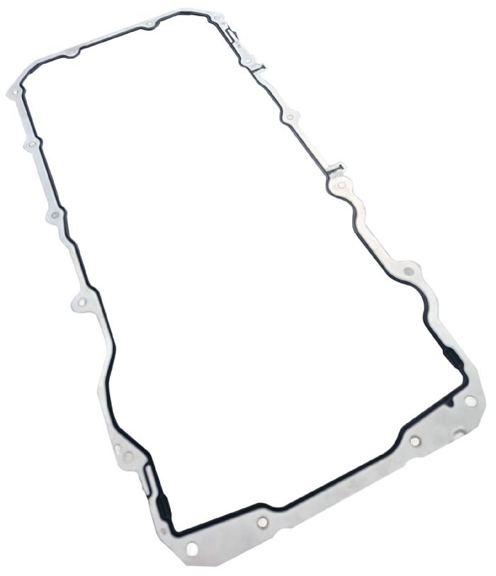

Much of the automotive work performed at TrimLine comprises transmission parts; a big runner is steel and aluminum gasket frames stamped as right- and left-hand parts in progressive dies. Those parts ship to customers who then load them into molds to receive gaskets—think transmission-pan or oil-pan gaskets, for example.

“We manage the feed settings through each part program,” he says, noting that the feed-line control and press control conveniently located next to each other, making it easy for the press operator should he need to fine-tune the feed program before starting a production run. “And, our press operators are highly trained, a few having attended Aida’s annual servo-technology symposium, and receiving advanced training. They’re able to program the presses and feeds themselves when we bring in new programs. That’s a huge benefit, versus having to call over a supervisor or engineer to program the jobs.
