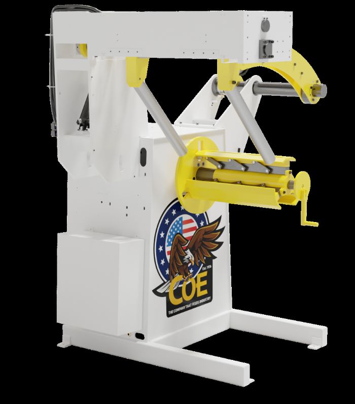

At FABTECH...Coe Press Equipment debuted a redesign of its single-reel uncoilers. Featuring a new modular design, the reels allow users to add optional features at later dates more easily, helping them to adapt to changing shop-floor needs. Additionally, whereas the previous model featured weldments, the new design employs bolted components, resulting in more robust and reliable reels, according to company officials.
The redesigned reels can handle coil loads to 60,000 lb., and process material with yield strength to 300 ksi. Use the reels for coil widths to 78 in., OD to 72 in. and ID to 24.75 in. The reels can be configured to work in pulloff applications with power straighteners and roll forming equipment, or can be provided as payoff reels with drive mechanisms to unwind the coil built into the machines, and with AC variable-speed drives in sizes to 20 hp.
