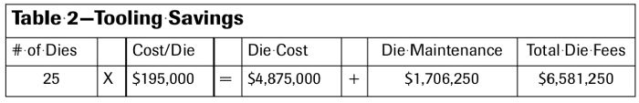

Table 2—Tooling SavingsLaser blanking, in eliminating the need for dies, offers an immediate savings of more than $6 million (Table 2). This also can be considered as a cost savings of $1.05/part (Table 3), with savings increasing should production decrease for any reason. Either way, this money can be re-allocated to a capital-equipment investment or deployed in part processing.

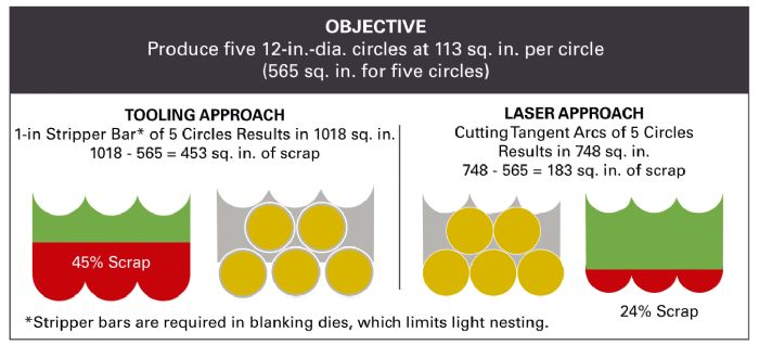

Table 3—Part SavignsThe combination of software-program advancement and flexibility of laser cutting enables nesting and optimizing material usage, to help reduce scrap. Typically, a family of outer-body panels will consume 14,000 tons of material per year at an average cost of $1600-$1700/ton. Assuming that a stamper receives a scrap credit of 0.10/lb.―or $200/ton,―then the material cost may total $1400-$1500/ton. Designing blanks to optimize the nesting advantages available through laser cutting can result in an annual savings of 1000 to1500 tons of material. This translates into nearly $2 million/yr. in coil-stock purchasing per year, or $9 million-plus across a 5-yr. program (Table 4).

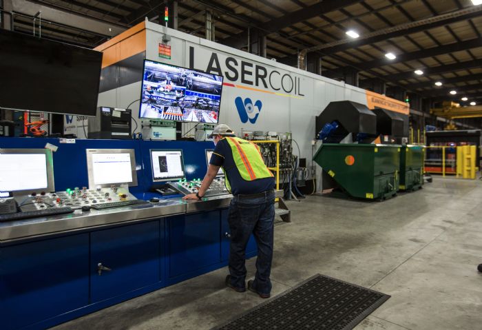

Lasercoil-lineThe ongoing argument against laser blanking has been focused on productivity and speed. Yes, a mechanical press only needs a single stroke to cut a blank profile, thus, it has been the technology of choice in high-volume blanking. However, the multi-head laser systems available today can give a stamping press a run for its money.

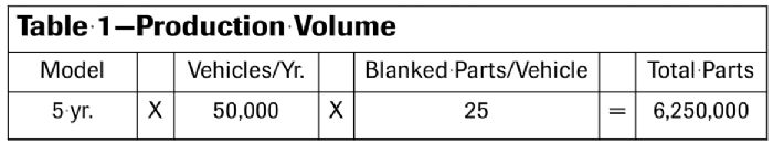

In a recent study on the time needed to produce 25 parts at volumes of 50,000, we found that a three-head laser system required 1400 hr. to process these parts vs. 1200 hr. using mechanical blanking. So, yes, laser blanking required an additional 200 hr. to run the same number of parts. However, investing in a four-head laser system would certainly meet the required production throughput. And, importantly, when considering the other benefits of laser blanking, it’s an investment worth making. Remember: Not having to produce dies already has gained at least 6 months in launch time.
In a real-life scenario involving a recent customer installation, and presuming a 5-min. die change, using a two-head laser blanking system to produce simple chevrons requires only 48 additional production hours for a 50,000-vehicle run across a 5-yr. span when compared to mechanical blanking. With an assumed operational cost of $1000/hr., this translates to $48,000 in additional operating cost for laser blanking. But, a straight-cut die will cost much more. And, when applying a 25-min. die-change time for such a tool, production via laser blanking beats using a mechanical press.
Look Beyond Strokes/Min.
Should productivity be the only desire, then stamping blanks may be the way to go. But, in addition to all of the savings stated above, keep these things in mind: A three-head laser cutting system costs nearly the same as a servo-driven blanking-press system, and requires a similar footprint. But, laser blanking systems often are designed for retrofit, meaning that they can work with existing coil-processing equipment. Plus, laser systems do not require a press pit or high-capacity crane for servicing, which helps to reduce overall facility costs. Additionally, not having to allocate storage for all of the die sets required to stamp the different parts running on a press line saves on floor space.
