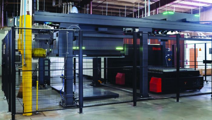

1-Nelson Steel-laser-automation-MazakFast forward to fall of 2023, when MetalForming took a hands-on look at what now is a single source for complete metal fabrication, including robotic welding, laser sheet and tube cutting, and assembly and packaging. Investment in automation, particularly for welding, machine tending and material handling, helps Nelson Steel Products ably serve a diverse customer set, including those in office furniture, agricultural and outdoor power equipment, and commercial floor cleaning. Three buildings—two adjoining and one about a half-mile away—total 150,000 sq. ft. of manufacturing space under roof, where 110 employees work across two shifts.

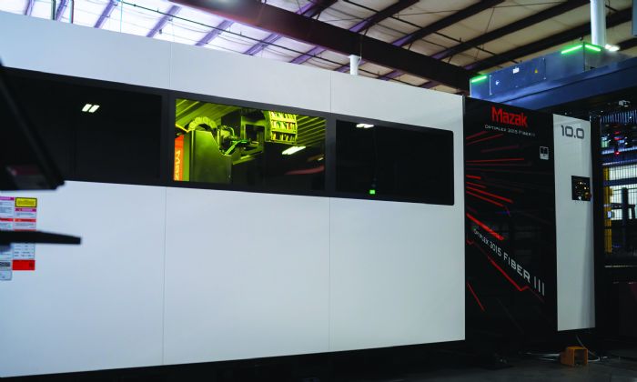

2-Mazak-Optiplex-laser-cutting-nelson-steelAs we can see, Nelson Steel Products is quick to adopt and expand on certain technologies, and add automation to optimize productivity. A dive into the company’s laser cutting evolution, including related material handling automation, drives the point home. Those first two laser cutting machines mentioned above, 1- and 2-kW CO2 models, had no surrounding automation, Ryzenga reports.

Laser cutting with automation at the firm arrived in 2011, in the form of a Mazak Model HTX 4-kW CO2 machine equipped with a flexible manufacturing system (FMS). The FMS consists of a storage tower to store and retrieve sheets of various specifications, pneumatic loading for positioning of sheets onto the cutting bed, and automatic unloading. With raw material loaded into towers, complete operation to finished part requires little to no labor, according to Mazak officials, who note that the high FMS capacity allows for unattended production throughout shifts and over weekends.
“This took us to the next level,” Ryzenga says.
In 2018, the company installed a Mazak STX 3-kW fiber laser cutting machine and fit it into the FMS, thus developing a two-machine automated cutting cell.
Nelson Steel Products then began its ascent into higher-power laser cutting in 2020 with a 10-kW Mazak OptiPlex 3015 fiber-laser machine, and added another of the same in 2022. Both of these units feature gantry-robot loading/unloading automation, one with a material-storage tower, the other without. Bringing in the 10-kW machines has allowed for cutting of some sheet gauges at five times the speed of cutting on the 4-kW machine, according to Ryzenga, so automation becomes a must to keep material moving.
“Now all of our flat-sheet laser cutting machines—the 3- and 4-kW machines and the two 10-kW machines—have automation,” he says. “We switch through multiple gauges of steel every day on those laser cutting machines, so we try to batch jobs with the same material thicknesses. The towers really help with organizing all of that—switching out gauges and having access to all of our material while saving floor space.”
Once offloaded, laser-cut sheets are stacked near deburring and other secondary operations for manual part removal and sorting, which doesn’t impede cutting production.
