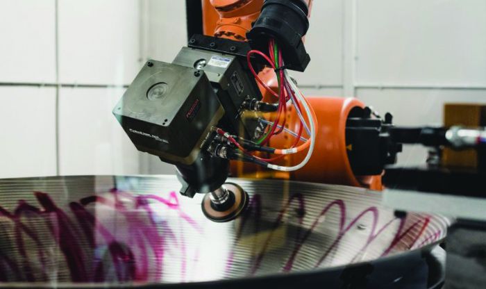

2-invio-automation-robot-grinding-kuka-3mTo provide insight on effective robotic-finishing solutions, Graham details a recent Invio Automation project designed to free a U.S. agricultural-part producer from the “three Ds” inherent in manual grinding: dull, dirty and dangerous. The spun-metal part in question—bowl-shaped—had required manual grinding via one worker per shift across three shifts—three full-time employees dedicated to the task. Specifically, the part producer sought to eliminate the safety risk presented by this manual process while creating a repeatable, scalable process versus the previous artisanal process that depended on a small number of highly skilled craftsman. A successful robotic-finishing solution in this particular application had to meet two fundamental challenges: grinding in multiple planes—vertical down, horizontal and everywhere in between on the bowl ID; and dealing with the fact that metal spinning can deliver parts with some level of surface variability where a grinding medium must maintain consistent part-surface contact despite imperfections.

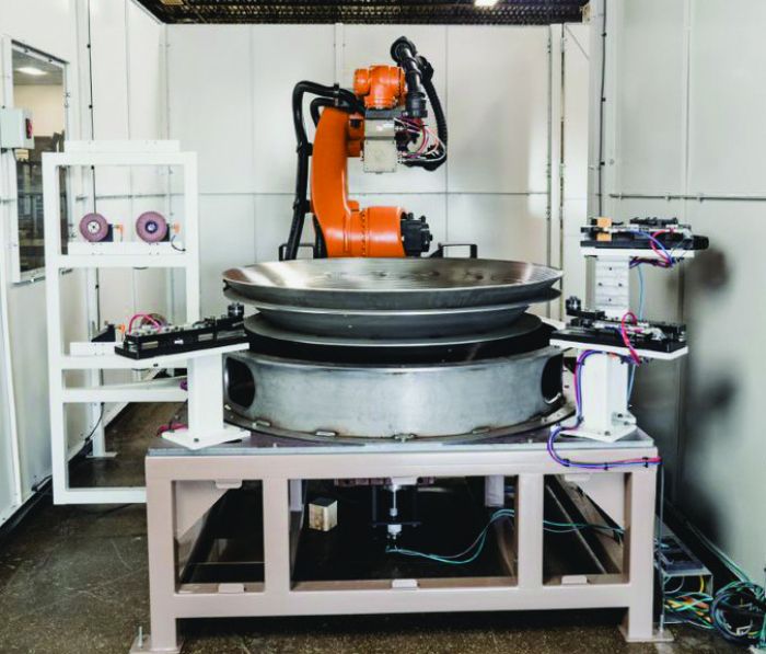

The heart of the robotic-grinding solution, as shown in the video above: a Kuka KR60 six-axis industrial robot, as well as grinding components and abrasives, and critical hardware and software, with Invio Automation and its Factory of the Future team responsible for integration.
Proper “Touch” is Key to Robotic Grinding
For this application, a servo rotary tool, the motor that spins abrasive discs, optimizes abrasive performance via programming for selecting and maintaining speeds, and also features an automatic tool changer. And, a force tool gives the setup its “human touch.” Attaching to the robot arm, this tool allows the servo rotary tool and abrasive to maintain contact with the workpiece surface at a specific force or pressure. Working with the metal former, Invio Automation provided the needed abrasive discs for this application, with programming provided through an intuitive user interface, Graham reports.
3-invio-automation-metal-sprining-robot-grindingIn this particular application, a worker manually sets the piece within fixturing on the worktable, though metal formers can opt for automating part placement and removal. In operation, the robot grabs specific end-of-arm tooling containing the selected abrasive wheel and performs grinding on the part surface, and changes out the wheel as needed—time-based in this application—depending on the finish desired. By working with the metal former, Invio Automation and other team members, through testing, determined the type of abrasive wheels needed, the sequence of their changeout and the time required for operation of each wheel—a key challenge of the application and a complex component of robotic-finishing automation.
The application requires typical robot-cell preventive and predictive maintenance, with personnel periodically checking on abrasive wear. By monitoring operation hours and through application usage, operators typically can predict abrasive wear and the need to switch out wheels. Following finishing, this part undergoes manual inspection and human retouching if needed. While vision systems offer inspection capability for many parts, grinding proves difficult for vision-based post-process inspection, Graham reports, thus human inspection likely would be needed in grinding applications.
The metal former in this application chose to run a single robotic-finishing cell, with low required part volumes and the intricacies of finishing operations limiting cell volume to about 300 parts/yr. Depending on finishing complexity and throughput needs, Graham notes that much greater volumes are possible, citing other Invio Automation applications that involve sanding via collaborative robots, for example. MF
