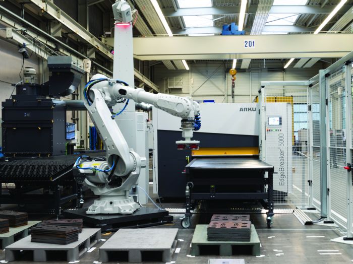

As for feeding parts into an automated deburring machine, robots can be added to pick parts off  the cutting table and transfer to a conveyor for transport to the machine. Another option, according to Weinfurtner, involves a vision-guided robot picking parts from a skid for machine feeding, and then restacking the parts after deburring. Automatic deburring machines also benefit from Industry 4.0 advances, he adds, with the ability to connect machines to other line components for full line control from a centralized point. It also adds the ability to connect numerous deburring machines together. Another machine option: deslagging, which comes in handy for torch-cutting operations such as plasma and oxyfuel cutting.
