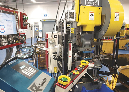

Of course when it comes to press run rates, just cranking up press speed does not easily nor automatically translate into increased throughput. Most notably, the accompanying adjustments made to the coil-feed line represent a critical success factor. And here’s where another unique capability of the Wintriss SmartPac 2 comes into play—it’s called Feed Advisor.
With SmartPAC 2’s Servo Feed Interface (SFI) option, available for most brands of servo feeds (including the Rapid-Air feeds that ARaymond has added to its upgraded press lines), users can program, store and automatically download feed parameters for each tool. With a programmed feed length, feed arc and press speed, the SmartPac determines whether or not the feeder can operate in the time available. It then calculates the minimum feeder acceleration rate required.
“Feed Advisor helps our press technicians and setup people by analyzing when the feed occurs relative to die closure,” says McCullah. “Without this feature, we would spend countless hours on trial-and-error feed setups to match new press-speed objectives. Feed Advisor instantly provides feedback on whether or not the feed window is sufficient, or if we need to increase the window to meet the established feed velocity and acceleration profile.”

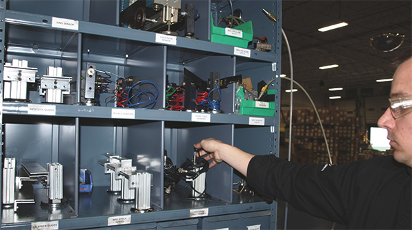

As the shop has become leaner and meaner, with no excuses accepted for not starting and completing production runs on time, plenty of attention has steered toward reducing changeover times. And as lot sizes have dropped in the last few years, the frequency of setups performed has doubled; setups can average 3-4 hr. This includes time to tool up a die, as well as sharpen punches and perform other maintenance tasks. To quicken the pace, 2 years ago McCullah and Stith instituted a pre-changeover team.
“We’ve shifted five people into proactive setup roles on the floor,” says McCullah. The extra labor became available as the additional use of die protection has allowed one press operator to now cover four or five presses, compared to two or three presses before. “This pre-changeover team uses our production schedule to prestage dies to help minimize changeover time. About 65 percent of our dies are prestaged, with the goal being 80 percent.”
Also helping to minimize changeover times is standardizing on sensor setups at the press. While developing a sensor strategy on its existing dies the first time around can take 2-3 hr., once a die-protection strategy has been developed, the technician documents the approach. This speeds the die-protection portion of the overall setup job the next time the die enters production.

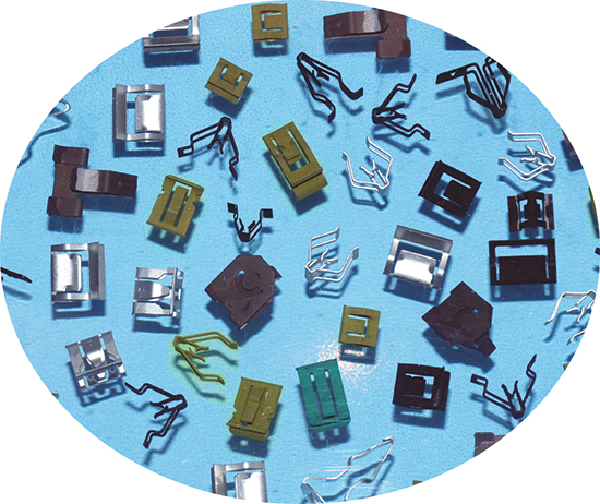

Of course, more work orders for smaller batch sizes adds stress to the shipping and receiving department, particularly since every box of stamped fasteners goes out for heattreating and plating. “We have a lot of work-in-process inventory,” notes Stith. “As productivity has skyrocketed and we’ve been able to remove seven presses from the production process, we’ve leveraged the gained floor space to improve our shipping and receiving operation. We can pack parts more efficiently, the work flow is more organized and logical, and it’s much safer.
