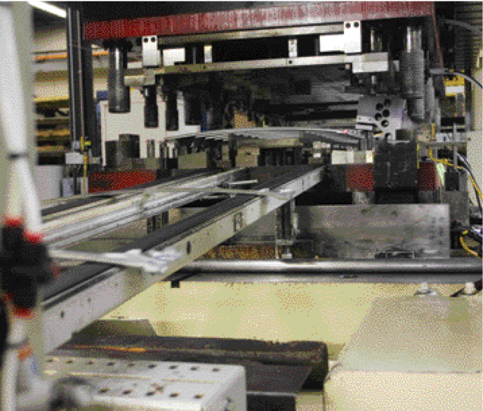

Part size and complexity called for the use of center-driven dual-belt conveyors. As rail length (width across the belts) changes from die to die, operators, as part of the job setup procedure, quickly shift one belt in or out as needed.
Once the mobile visual-inspection system was built, installed and debugged to ensure repeatable delivery of the rails in a predictable pattern, all quality concerns vanished. In fact, the setup worked so well that over the years Tella Tool has constructed a total of five of the mobile inspection systems—conveyors and all —for use at its Lombard plant, and a sixth mobile visual-inspection station for use at its 50,000-sq.-ft. sister plant in Brownsville, TX.
