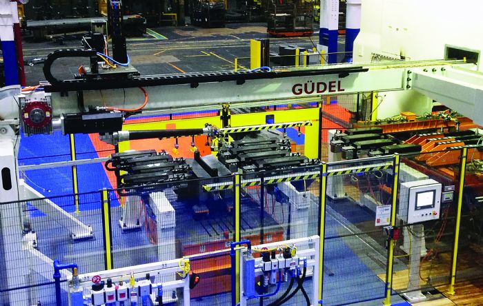

2-Press-Automation-Gudel-linear-motion-front-of-lineDiving more deeply into the intricacies of drive systems, Engelking lists the four main linear-motion technologies often found in higher-end, highly repeatable automation: linear motors; timing belts and pulleys; ball screws and nuts; and rack-and-pinion.
“Mechanical friction always is present, so equipment makers constantly seek smoother designs with lower coefficients of friction, which reduce overall energy costs in running linear-motion systems,” he says.
Equipment makers stay busy helping to ensure proper performance and uptime. To this end, Güdel offers a condition-monitoring package. Monitoring vibration, noise, temperature and accelerometers on drive and bearing components helps predict failure. Vibration, noise and temperature spikes all serve as warning signs of impending issues.
