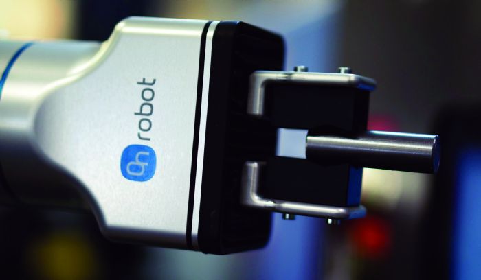

Cobot-Electric-Gripper-EOAT-OnRobot“We see press end-of-line applications for cobots and robots mostly including packaging and palletizing,” Hulgard says. The choice between cobots and industrial robots in these applications chiefly depends on line speeds and part size and weight, with manufacturers and automation integrators preferably huddling to assess needs and develop the appropriate solutions. Whereas the perceived ruggedness of cobots has made deployment in sometimes-hostile press-line environments an iffy proposition, this no longer should be of concern.

“We see a move from highly customized one-off-designed EOAT toward more-standardized electric, one-size-fits-all tooling,” he says. “Traditionally, a manufacturer would purchase a pneumatic gripper that could grip one part, one shape and one size, and it did that very well. However, what if a metal former wants to use the robot or cobot to move different sizes and shapes of materials. An electric gripper, via a software setting for finger reach and manipulation, easily can grip differently sized and shaped parts.”
In addition, the flexibility of electric EOAT allows redeployment of cobots for other tasks and enables productivity gains and cost savings when picking differing parts in high-mix, low-volume production, according to Hulgard.
Hulgard’s two cents: “Electric and software-driven EOAT is the way to go, and represents the future of tooling.”
Data gathering and analysis offers another plus of such technology, according to Hulgard. “Electric tooling allows users to monitor and measure productivity and performance of the EOAT as a whole and of the grippers. Did I grip the part correctly? Do I have a grip now? Together with the monitoring software, a metal former can determine if the automation is running correctly. Traditionally, that hasn’t been possible with pneumatic EOAT.”
