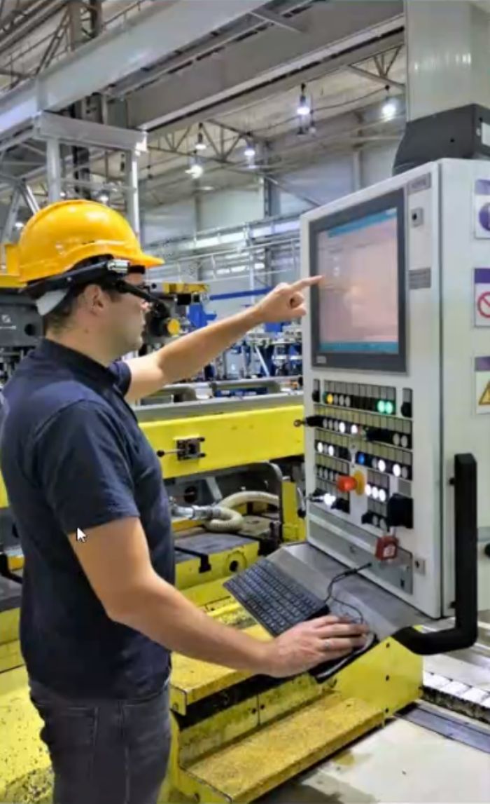

A lack of experience in maintenance personnel may call for a digital solution as well. Machine providers have responded, with remote audio and video connecting plant maintenance associates and machine service technicians.

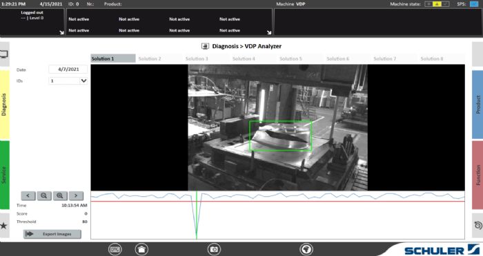

Pressroom digitalization reaches beyond production monitoring to provide for added die protection. All manner of sensors in the press bed and dies allow real-time assessment and provide data for analysis. Now, metal formers have eyes within the press bed to watch the forming process and see exactly how material, the ram and tooling interact. For example, Schuler’s Visual Die Protection (VDP), part of the company’s Digital Suite forming-technology networking solution, detects foreign objects or other sources of danger in real time and stops the press before damage occurs, and drills down to determine why such faults occur. This again shows the power of a digitalized pressroom.
"In the visualization, deflections in the time curve can be used to quickly gain an overview of exactly when deviations from the normal state have occurred,” says Rohitashwa Pant, Schuler chief digital officer. "The user can call up the images associated with these points in time in a targeted manner and recognize, for example, that parts are lying on a centering pin and are not threaded, or that punching scrap keeps piling up in a particular scrap chute."
Appropriate changes then can be made to avoid future production interruptions, increasing process stability and, ultimately, output. The system also allows the export of the time series and image data for documentation and later comparison.
While vision systems have been employed in such settings, the ability for automatic recall and analysis via software, such as with VDP, provides a new layer of capability.
"With conventional cameras, press operators can monitor the die area,” says Werbs, “but then must laboriously evaluate the videos themselves afterward. Automatic analysis takes this work off of operators’ shoulders.”
