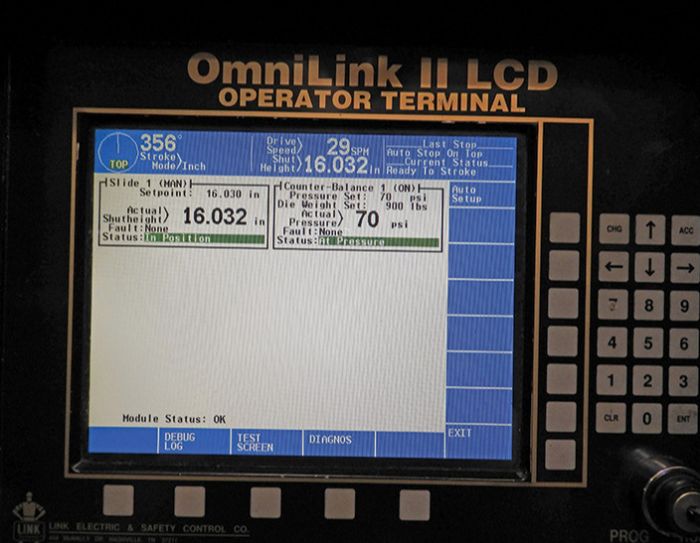

Sensor for scrap systemState-of-the-art press controls, with the proper addition of sensors, can help automate many setup tasks. Controls can monitor and control variables such as shut height, counterbalance pressure and cushion pressure. Upon job recall, the setup person can initiate these actions while moving on to perform other tasks that cannot easily be automated. Then, sensors ensure that the actual settings match those in the stored job recipe. Setups occur more efficiently, and when training new hires we can be rest assured that settings in the job recipe will return to optimal values, per the job recipe created by a more experienced setup person.
Modern press controls also can communicate with and send signals to equipment up and down the press line—feed lines, transfer systems and other auxiliary equipment. These machines in turn recall the matching recipe and initiate automatic adjustments for the next job. As a result, not only do setups occur more quickly and accurately, but labor is reduced. We eliminate the bending, stooping and turning of cranks, and the use of hand tools and other manual tasks, making setups easier and less tiring, and minimizing the risk of injury. And, for new hires, the job becomes more enjoyable, improving retention.

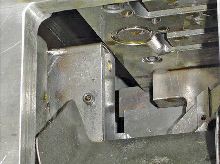

In addition to press monitoring, sensors also can monitor the tooling and even the auxiliary equipment around the press. Tooling sensors first and foremost provide protection to prevent die crashes. Sensors can detect critical events during press operation and if events in the tooling fail to occur as required, they signal the press control to issue an emergency stop command to halt the ram motion—quickly and before tooling damage occurs.
One disastrous, damaging press stroke leads to more than just the cost of the parts required to repair the damage. The metal former also must account for the labor costs associated with calling to the scene an experienced die maker, as well as additional costs for an expedited repair or overtime hours on weekdays or on weekends. While all of that happens, the press sits idle while production scrambles to identify the next job it can run and set up the tooling and coil.
advanced press controlAmong the events monitored by sensors in progressive dies, feed progression perhaps is the most critical. During material feed, several opportunities for errors exist that can prevent accurate strip advancement. Among them: The feed can slip; the stock can buckle if it encounters resistance due to camber or wear; punches can snap off and prevent the stop from advancing; and scrap can fail to drop and block the advance of the strip. There is little room for error, as the tooling requires strip positioning with accuracy measured in the thousandths of an inch.
As a relatively simple way to monitor strip progression in a progressive die, stampers can place grounding wires in the tooling that the strip contacts when in its final feed position. Other more precise options: Install proximity sensors to monitor the strip; use sensors to detect the position of a French notch-style lever-arm; or use a fiberoptic or laser-type sensor.

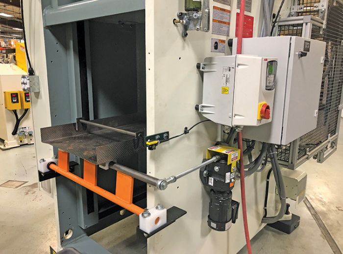

The value of sensor applications does not stop where the tooling ends. Sensors also find use for monitoring press-line auxiliary equipment. Examples include scrap systems that must continue to run as the press strokes; scrap backups can cause huge problems. End-of-coil sensors on coil lines can trigger a press stop before it is necessary to tail-out in a more deliberate way. Sensors also can ensure that lubrication systems have oil in their reservoirs, so that tooling does not run dry.
Finally, stampers rely on sensors to continuously monitor for part quality during production. Relatively simple examples include deploying stripper level sensors that stop the press if slugs or other foreign objects make their way to the top of the strip or part, or sensors that directly measure part features during the process. Using analog sensors for part measurement, in vision systems and at gauging stations in the tooling can add a whole new level of capability to the pressroom.
All of this allows stampers to operate their press lines safely and without constant, direct operator monitoring. When installed and used properly, especially in applications where small parts are bulk-packed into bins, process automation using modern press controls and sensors can allow a single operator to effectively run multiple presses. MF
