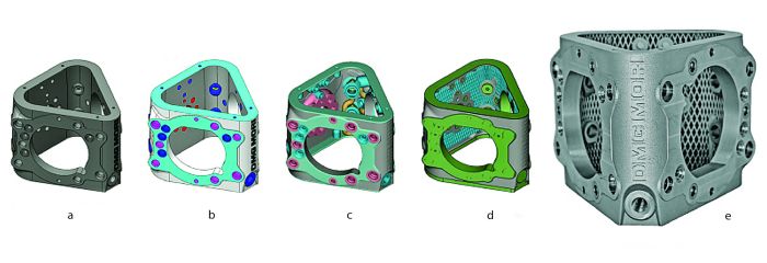

Fig 1 process overview“With nTopology, we were able to create a powerful and unique additive design. It wouldn’t be possible to create such a component with a traditional CAD system,” explains Martin Blanke, an AM project engineer at DMG Mori. The primary goal of the project: develop a lightweight design with the same external form factor as the original assembly but with a reduced number of components and weight, which meant finding a way to maintain the original structural profile while removing as much material as possible from the interior.

  • Color-code all surfaces of the original design in CAD, each color corresponding to a different subsystem and later used as an input parameter in the topology-optimization software to determine the thickness of each section.
  • Import the CAD file in nTopology and shell each section before combining them into a single body. The thickness of the outer shell was driven by topology optimization to maximize its stiffness.
  • Fill the interior volume with a conformal lattice to increase the part’s structural strength and create a support structure for AM. Using nTopology’s engineering simulation tools, the team rapidly iterated to select the optimal lattice.

Instead of just designing a one-off lightweight component, the design team developed a robust and reusable optimization process. It based the reusable workflow on the color-coded surfaces of the imported CAD body. First, the team defined colors for the surface of each subsystem in an external CAD system: blue for the pneumatic inlets and outlets, yellow for the pneumatic channels, red for the interfaces with the robot, purple for mounting points, green for contact surfaces, and white for the external surfaces.
It then used the color property in nTopology to select relevant surfaces and develop a reusable workflow. If the input geometry changed in future iterations or other projects, the team would only have to import the new CAD file and the optimization process would automatically rerun.

With the exterior shell developed, the team turned to the structural and pneumatic systems, also seeking to reduce their weight and integrate them into the design. Using the color-coding system, Blanke’s team easily was able to apply a different constant shell thickness to each subsystem. For example, designers could assign pneumatic inlets and outlets a greater thickness than those specified for the pneumatic channels, a process not nearly as straightforward to perform with traditional CAD tools.
The last step of the process, which Blanke calls “one of the main advantages of using nTopology:” With the separate shells generated, the designs were then combined into a single body using a simple boolean union. The boolean union block joins multiple implicit bodies into one with optional blending between them to add fillets.

A few tasks remained, chief among them: Many interior features comprised large overhangs not conducive to metal AM, as the team sought to avoid excessive use of support structures and the tedious, wasteful process to remove them. Therefore, the engineering team used lattice structures to provide permanent support to all interior regions of the part. Additionally, the internal lattice structures increased part stiffness.
To identify the optimum lattice thickness, the team leveraged nTopology’s integrated simulation tools to automatically run multiple finite-element and lattice simulations, quickly evaluate the results and adjust specific parameters to iterate and optimize their design. The software’s integrated engineering simulation and design-automation capabilities saved Blanke’s team many engineering hours, as moving to a different software would only add complexity to the workflow.
With the design complete, only a few final details needed to be added to prepare for manufacturing and post-processing. For example, any holes and hollow areas in the final model could have led to imperfections during the AM process. So, Blanke and his team filled most of these sections with solid material that easily could be CNC-machined afterward.
After 39 hr. of metal AM in the Lasertec 30 Dual SLM machine, and then finishing using five-axis CNC machining, the team finally had four physical prototypes of its new lightweight design ready for testing in the robotic system. Early tests showed that the new component’s higher stiffness-to-weight ratio helped improve the robotic system’s handling precision by a factor of 16. Now the team is planning to apply a similar methodology in nTopology to lightweight other similar components.
