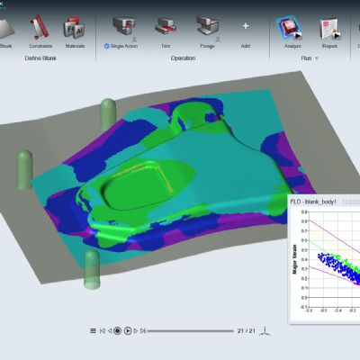

hickness map, provided by ETA
This thickness map, provided by ETA, shows how software can predict the thickness of a stamped part—just one of many capabilities available in forming-simulation software.

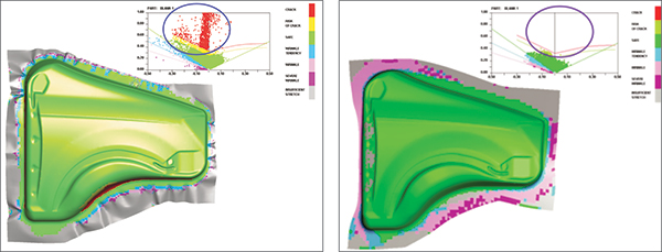

Advances in optimization have enabled simulation software to cut weeks off of development time.
Advances in optimization have enabled simulation software to cut weeks off of development time. Within a day, sophisticated solving work can take a simulated part (such as this vehicle fender, left) and optimize it (right) with the ideal draw-bead placement. Photo courtesy of ETA.
