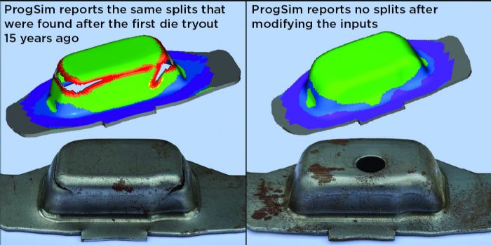

Nick also uses ProgSim, an optional add-in to LogoPress DieDesign, on a regular basis. ProgSim provides forming simulation of progressive dies based on an incremental approach, addressing formability and springback issues during strip layout. This feature provides feedback on key stamping-quality issues, such as wrinkles, splits and excessive thinning. Referred to as a virtual tryout press by LogoPress officials, ProgSim also includes automatic blank development via Cut Optimizer.
“Trademark Tool Designs uses ProgSim for incremental forming simulation as well as automatic blank development,” says Ray Proeber, president of Accurate Die Design Software. “The ability to have both mechanical simulation tools as well as incremental forming simulation tools running inside the die-design software enables the company to perform mechanical debugging as well as debugging of the forming process. The fact that LogoPress DieDesign software runs inside the SolidWorks CAD environment, and Die Debugger and ProgSim run inside of the LogoPress environment, makes the entire process simple to set up and use since there is a familiar workflow.
“Now that Trademark Tool Designs, a long-time LogoPress user, can debug the forming process and develop the net flat blank shape even before the die design is delivered to the customer, this puts the company on a new level,” Proeber concludes.
