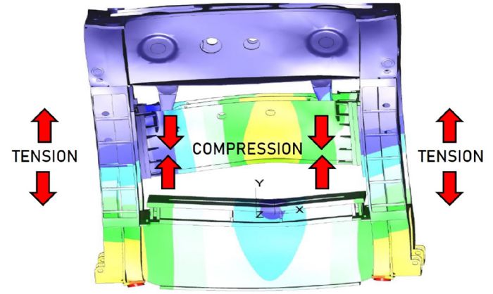

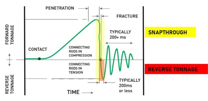

Fig.1 Deflections on a pressIn operations such as blanking or piercing, the stress configuration leading to forward tonnage (Fig. 1) may be reversed. In these operations, when the material reaches its plastic limit and fractures, all of the energy stored during deformation suddenly is released. This leads to a quick acceleration of the slide components, generating  snapthrough. Fig. 2 shows a load vs. time graph, with snapthrough represented by a sudden drop in load. A large-enough drop takes the connecting rods from compression into tension, creating reverse tonnage.

Fig. 2-Reverse-Tonnage-Snapthrough-NidecSnapthrough, or quick acceleration of the slide components, can lead to excessive noise, vibration, loose components, leaks, premature wear, broken tools, part-quality defects and press-component fatigue. Due to its nature, the effects of snapthrough should be measured using accelerometers, as it cannot be measured with strain gauges attached to the uprights.

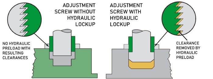

Press design represents a major factor when dealing with reverse tonnage and snapthrough, and as mentioned, reduced clearances in the machine are key here. Reduced clearances can be achieved with mechanisms such as a hydraulic slide lockup, which removes all clearances in the slide adjustment parts (Fig. 3). Other helpful press-design factors include the use of cast-iron components, which dampen vibration, and robust connecting elements such as wristpins.
