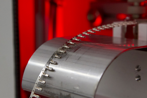

“In some cases, rebuilding machines for certain products makes sense; this wasn’t one of those cases,” Rupp says, explaining that Weiss-Aug’s stamped parts are small and complex, and rarely flat. Coined, formed and bent multiple times, tolerances are as tight as ±0.0005 in. while part quantities number in the millions. Materials used include stainless steel, beryllium copper, beryllium, phosphor bronze, nickel and other alloys.
“When we began running the same dies, making the same parts in the new presses, we couldn’t believe the improved consistency within production runs,” Cole states. “Not only were we able to increase press speeds, but most of all the new machines reduced die maintenance. Dies also had to be adjusted less frequently, reducing downtime. In summary, productivity rose significantly.”

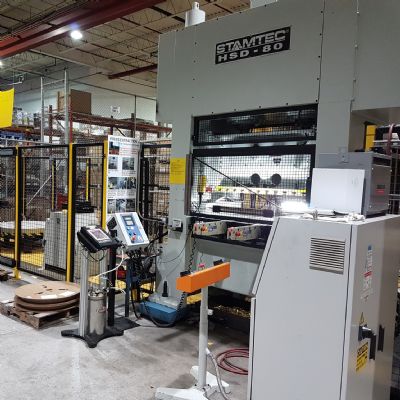

Rupp notes a press feature that he says ensures consistency: the mass counterbalance system distributes the press’ forces more evenly throughout the machine, thereby maintaining its stability at high speeds.
