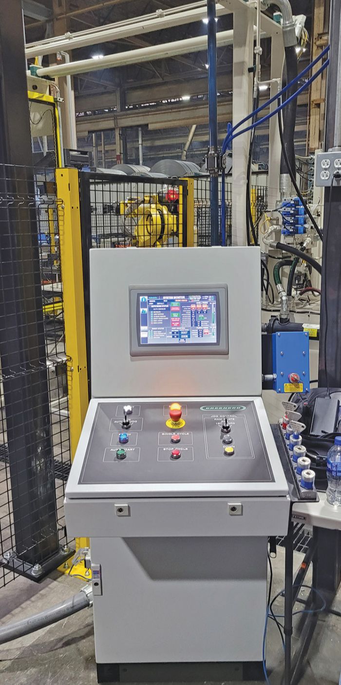

Using touchscreen press controls, all press-setup points—including those for top stop, slowdown and reversal—easily can be changed. This eliminates the need for time-consuming manual adjustments, and such a closed-loop system adjusts itself to match process parameters. A control’s safeguards even can reject incorrect settings, preventing costly accidents. In addition, ram position is tracked by a linear transducer, which rarely needs calibrating. The control can be integrated with a precision digital control system, which enables actual position accuracies of ±0.001 in. and reversal at ±1 percent of specified tonnage.
Repeatability has improved dramatically thanks to the use of new PLCs and valves. Metal formers can store multiple programs or recipes in the controllers, which can be accessed as needed—a big advantage compared to manually entering program parameters each time a new job runs. This automatic process can eliminate the need for a setup operator, requiring only the press operator to call up the program already loaded with values that have been checked by performing qualifying runoffs. Depending on PLC memory capacity, hundreds of recipes can be stored, enabling the press operator to change programs in just seconds and ensuring that parts are produced precisely and repeatedly every time they run. Modern PLCs also are flexible enough to allow the use of multiple programming languages to best suit the current requirement.

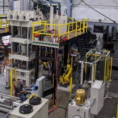

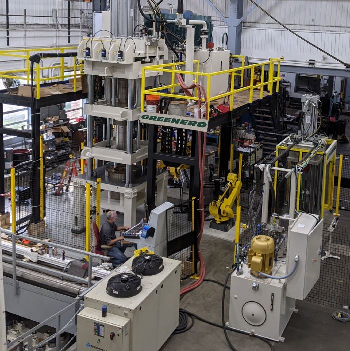

New PLCs enable process automation by controlling multiple presses within a line, or by integrating a press with auxiliary equipment. This automation provides consistent control over all press operations. Typical applications include adding roll feeders for advancing sheet metal, rotary-index tables or robotic material handling built into a press line.
