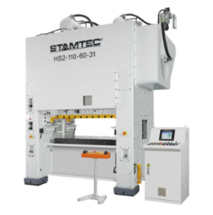

Stamtec has unveiled its HS2 series of high-speed mechanical
presses, with an eccentric shaft engineered to be stronger than a traditional
crankshaft. The HS2 series is available either flywheel-driven with its
eccentric shaft directly coupled to the flywheel with no reduction gearing for
higher speeds, or gear-driven with its eccentric shaft with reduction gearing
for more torque at slower speeds. It is equipped with precision, dynamic
balancing for vibration reduction. Standard on all HS2 presses are motorized
slide adjustment, e-stops, air connectors and automatic oil cooling. Capacities
in 110, 165, and 220 tons, with speeds to 500 strokes/min. Other press
features include a recirculating lubrication system with oil cooling and
heating and hydraulic stick-release device.
