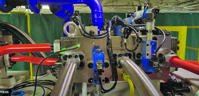

Incorporating servo motors in hydraulic-press setups has allowed machine builders to eliminate hydraulics previously needed to control ram-cylinder force and direction. That’s important, as while standard hydraulic presses have improved greatly over the years in terms of leakage and wear of pumps, valves, hoses and fittings, stampers still, at a time and money cost, must perform monitoring and maintenance of hydraulic components. And, a lesser hydraulic footprint translates to less oil usage, meaning less need for cooling components for hot oil. With these burdens eased, servohydraulic presses can offer savings to 30 percent in maintenance time and costs as compared to traditional hydraulic presses, according to some press builders, along with longer service life.
Though servohydraulic technology does reduce the need for some hydraulic components, those components remaining have been optimized. For example, Macrodyne employs pressure-compensated axial piston pumps with electronic pump control, extreme high-pressure piston pumps and servo-controlled valves, according to company officials, which help deliver precision servo-controlled programmable motion and power when needed.
For its part, Sutherland Presses touts a combination of active fluid management and advanced servo motors that adjusts fluid volume and motor speed to match the required workload, enabling dynamic adjustment of tonnage from 10 to 100 percent at any point in the stroke cycle.
And, Greenerd’s new closed-loop servo-hydraulic system dramatically improves stroke depth control, it says, guaranteeing consistent, repeatable results. In many applications, this system eliminates the need for “kiss” blocks.
Put it all together and servohydraulic presses can achieve pressure repeat accuracy of ±1 percent.

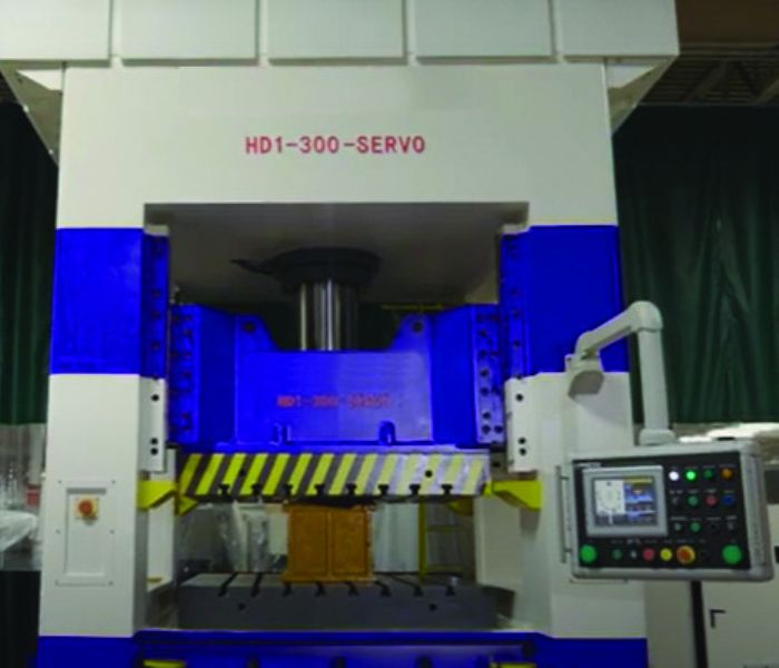

Similarly to servomechanical presses, automotive is the big application driver that brought servohydraulic presses to North American shores. The need for high forces to shape aluminum in automotive stamping, for example, cried out for a servohydraulic solution, but press builders had to contend with challenges related to high-speed production and the resulting energy usage. They have met those challenges with today’s technology, and automakers and tier suppliers increasingly rely on servohydraulic presses for this type of work.
The technology also proves beneficial in hot stamping applications where high forces must be held longer on ever-stronger materials. Dialed-in stroke parameters enable more intricate and precise work on these materials without overly stressing already stressed tooling. Other applications include motor-bearing press fitting, electrical-connector press fitting, press hardening and composite-material forming.
Find these presses in transfer applications as well, and, of course, in deep drawing, where traditional hydraulic presses have shined for years. Consider servohydraulic presses, uniting the consistently high force delivered by hydraulic presses with the stroke-control capabilities of servomechanical presses, when you need programmable power. MF
