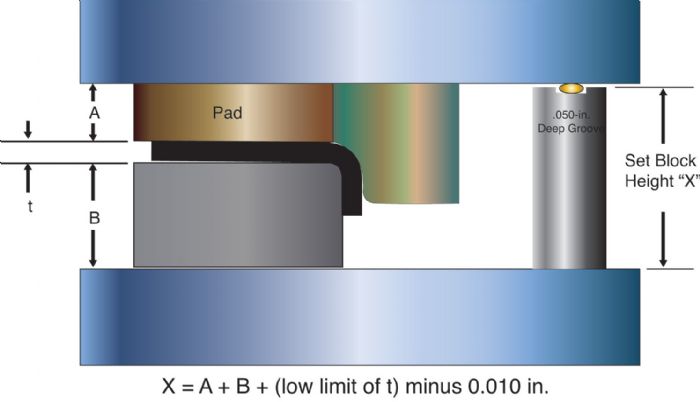

Unfortunately, no industry standard describes how to establish the set-block height, the depth of the solder-check groove or procedural steps for making final shut-height adjustments. Fig. 2 provides one option that allows a die setter to set the die shut height relative to material thickness.
The inside shut height for this die is the sum of the pad thickness (A), die thickness (B) and the low limit of material thickness (t). The height of the set block should be less than the calculated shut-height dimension to assure that the set blocks do not contact the upper die shoe (eliminating false-tonnage readings). This height reduction is arbitrary, but can range from 0.002 to 0.020 in.
I used 0.010 in. for the height reduction in Fig. 2, making the formula for the set block height:
A + B + (low limit of t) minus 0.010 in.
The groove depth, also arbitrary, typically ranges from 0.040 to 0.060 in. In this example I use 0.050 in.
Establishing the Shut Height
With the die stations fully loaded, place solder in the set-block grooves, stroke the press and measure the solder thickness. With the material thickness at its low limit, the flattened solder thickness should equal 0.060 in. As material thickness increases, so should the thickness of the flattened solder. For example, if material thickness measures 0.008 in. above the low limit, then the flattened solder should measure 0.068 in. with a correctly set shut height.

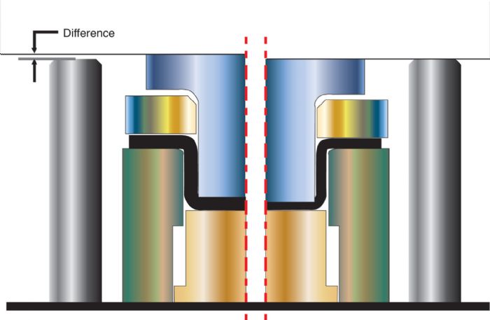

With a correct die shut height for the material thickness in the die, personnel have no reason to adjust the shut height until the material thickness changes. Far too often the die shut height is altered to compensate for timing issues inside of the die, such as a stencil hitting too hard or too light, or a sprung-open or overbent flange. After correctly setting the die shut height, never adjust the ram up or down to increase or decrease pressure for stencils and forms. These timing issues must be corrected by means of shimming.
Fig. 3 shows a bending station with a form block (or an insert) designed for simple removal in the press to facilitate adjustments. Now, forming pressure can be increased or decreased to adjust springback by adding or removing shims under the punch.
