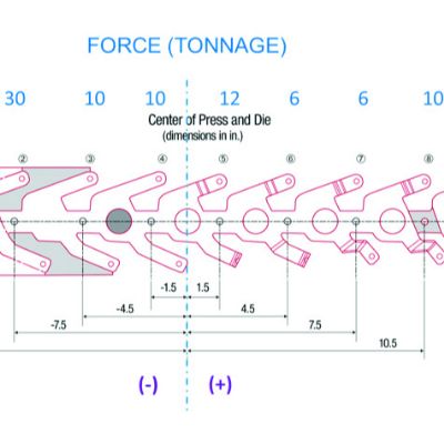

Fig2-Layout-for-progressive-die-stripTo calculate the tipping moments produced by a die, we multiply the cutting and forming forces by their distances from the center of the press. Using the center of the press as the origin (zero), distances to the left have negative values, with positive values for distances to the right, as in a number line. In a perfect world the sum of all of the moments would total zero, indicating that the center of the load is balanced at the center of the press.

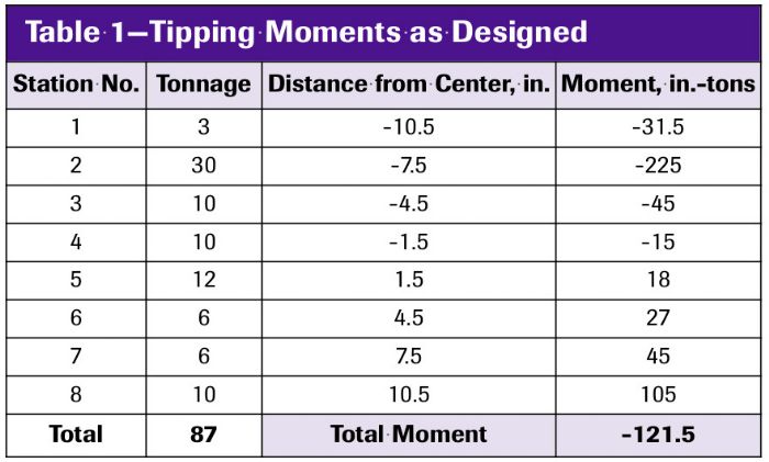

The strip layout in Fig. 2 applies to an eight-station progressive die. Table 1 displays the cutting and forming forces for each station and their distances from the center of the press. The last column in the table provides the resulting tipping moment (tonnage times distance from center) for each die station.
The sum of all of the moments in Table 1, -121.5 in.-tons, indicates that the loads acting on the slide are not balanced about the press centerline. To find the center of the load, divide the tipping moment sum by the total load for all the die stations:
-121.5 in.-tons divided by 87 tons = -1.4 in.
table-1Thus, the center of the 87-ton load locates 1.4 in. to the left (negative value) of the press centerline. To center the load, shift the die 1.4 in. to the right. The goal here is to position the center of the load, not the center of the die,―on the centerline of the press slide.

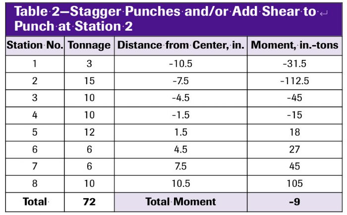

Table-2Another option: Strategically apply cutting shear and/or stagger select cutting punches. For example, we could reduce the cutting force in station number two by nearly 50 percent by staggering the punches by approximately one-half of sheet metal thickness or by adding shear. Table 2 shows the resulting reduction in forces and tipping moments.
