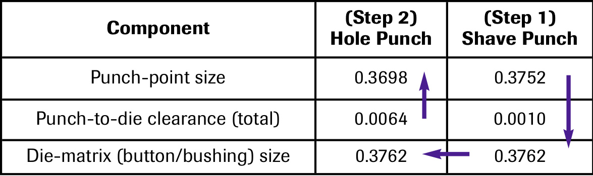

Assume that 0.032-in.-thick mild steel requires a shaved hole with a finished diameter of 0.3750 in. What size should the punched-hole diameter be before shaving?
Start with the finished-hole diameter and work backward. When specifying the shave-punch diameter, remember that the resulting hole size will measure slightly smaller than the actual punch size—usually 0.0002 to 0.0004 in. smaller—due to elastic recovery after shaving. For this example, we will use 0.3752 in. as the shave-punch diameter.
Fig. 1 depicts the next steps to determine the die-matrix and punched-hole diameters:
  1. The die-matrix opening should measure 1.25 to 1.50 percent of sheet metal thickness per side larger than the shave punch: 0.032 in. x 1.5 percent = 0.0005-in./side. Thus, the final matrix diameter measures 0.3762 in. The matrix also should be designed with a 0.25-in. land before transitioning into 0.5-deg. taper.
  2. The die-matrix diameter for the punching station should equal the shave-matrix diameter: 0.3762 in.
  3. Subtract the cutting clearance (10 percent per side) from the die-matrix diameter.
  4. The result provides the punch-point diameter: 0.3698 in.

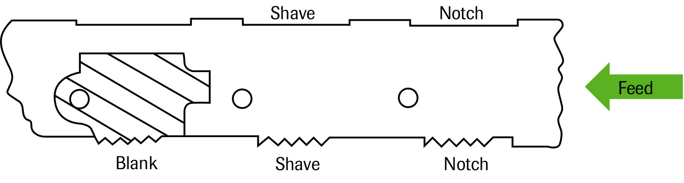

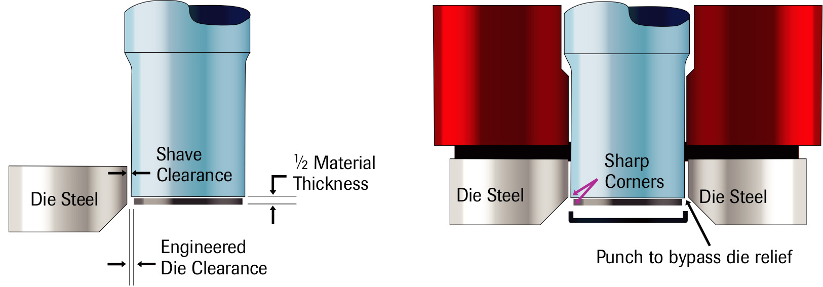

When shaving free edges, the parameters for punched holes also apply. In addition, the free-edge shave punch must be heeled and properly supported to prevent deflection due to the unbalanced cutting forces. When possible, consider cutting and shaving opposite sides of the die strip to provide balanced loading side-to-side in the strip (Fig. 2).

Another option: Design the punching and shaving stations such that the punched-hole slug retains the shave slug. Fig. 3 depicts a method using a single-step punch design, with the shave diameter determined by step 1 in Fig. 1. The punch-point diameter is determined by step 2, the point length restricted to one-half of the sheet metal thickness. This allows the hole to be punched and shaved in a single station with good control of the shave scrap. A major disadvantage here is difficulty in resharpening the punch.

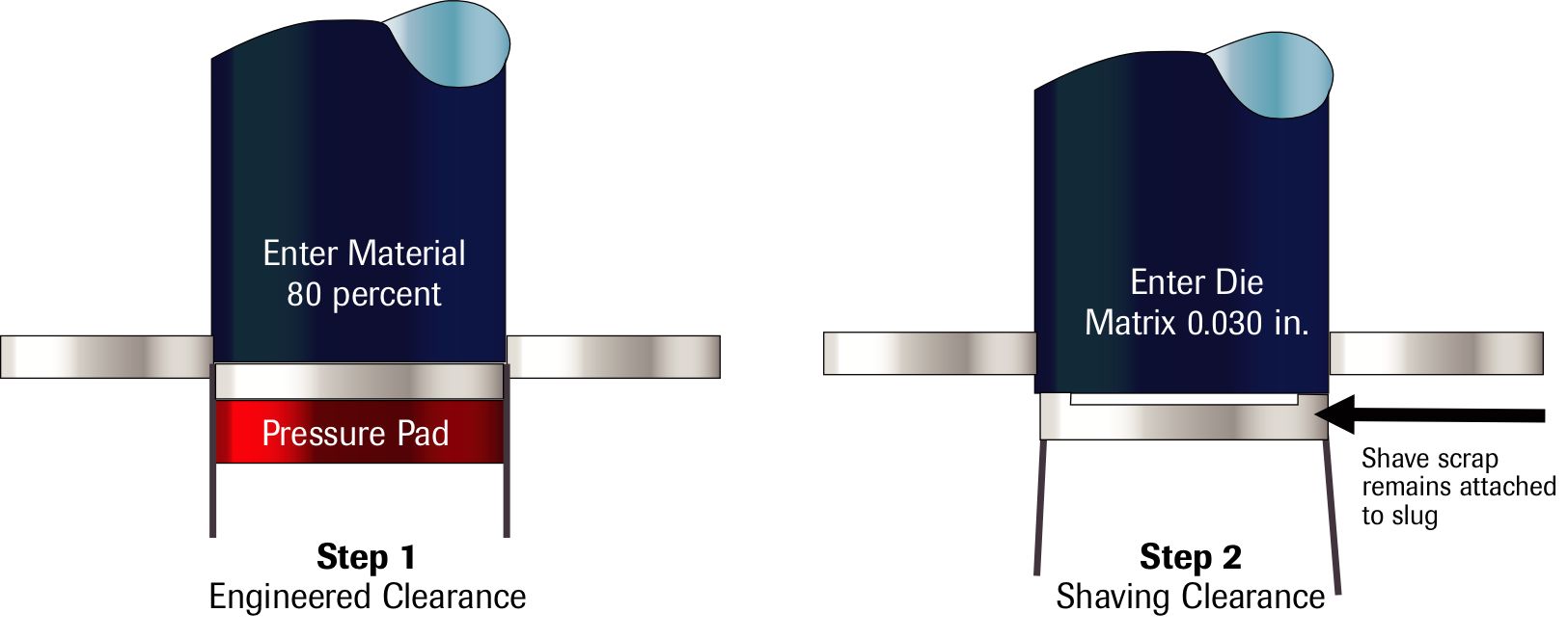

Fig. 4 illustrates a more traditional two-step method. The exception here: The slug is retained in the die strip through the application of counterpressure, limiting punch entry to 80 percent of material thickness. In the next station, the hole is shaved, and the slug ejected with the shave scrap attached.
