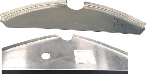

“During one recent ergonomic survey of the fabrication shop,” says Pederson, “we identified one specific job that scored very high on the ergonomic scorecard: flanging of sheetmetal bulkheads (of which four or five are riveted into each boat). The job required an operator to manually index sheetmetal blanks through a 1940s-vintage flanging machine.”
Based on factors such as hand position, the amount of repetitive motion involved, vibration and force required to do the work, the ergonomic scorecard rated that job the third poorest task in the entire plant. While the company had tried to find a better method, it recently worked with its press-brake supplier, LVD, and tooling company Wilson Tool, to come up with an automated flanging operation.
Wide-Mouth Press Meets Custom Tooling

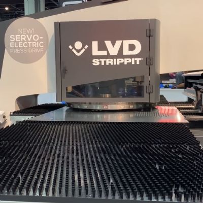

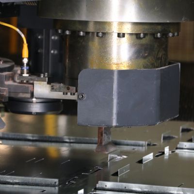

The solution to the New York Mills flanging challenge: implementation of a new 20-metric-ton Strippit PX punch press from LVD, boasting 3 in. of punch-die clearance for optimum forming capabilities, equipped with a custom Wilson Tool Opti-Bend tool designed to flange curved profiles. A rotating cam in the die bends the material during the punching stroke, simulating the cycling of a press brake without marking the sheet. Wilson Tool modified the rocker to, in concert with the way in which the sheet indexes in the press, create the curved flange.
Each boat manufactured at the Brunswick factory includes five or six of these supports, fabricated from 0.063- and 0.080-in.-thick Type 5052-H34 aluminum. Flanging the parts manually using a 1940s-vintage machine created inconsistent results (bottom part) and was not a very ergonomically sound job. Forming the parts on a punch press with a custom upforming tool automated the work and led to much more consistent part quality (top). |
Of note: The H34 temper on the aluminum stock means that the material is strain hardened, and then stabilized, to a strength that is roughly halfway between annealed (O) and full-hard (H38). That gives it good workability, in addition to good corrosion resistance, high fatigue strength and good weldability.
LVD markets the Strippit PX press, installed at the New York Mills plant in January 2017, for punching, bending and tapping. It boasts, in addition to the added bending capacity, a 20-station tool carousel; maximum hit rate is 505 hits/min. at a 1-in. pitch. Nominal workpiece capacity on the machine is 60 by 120 in. However, to accommodate larger sheet sizes and to avoid drooping of the relatively thin work, LVD worked with the facility to equip the machine with an additional 40 in. of table length.
