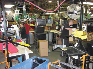

Newly designed assembly cells at R.W. Beckett locate assembly workers in the center, facing out to access parts bins filled by a crew of shoppers, as well as their workstations. There’s no turning and twisting, which has led to a significant gain in productivity.

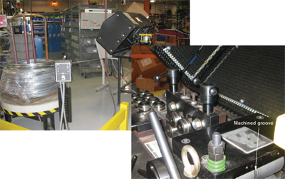

Bringing cut-to-length wire-rod processing inhouse, the company set up a small pneumatic press, fed, again, by a P/A servo feeder. Wire comes in on 1000-lb. spools; two sets of straightening rolls, a seven-roll horizontal set and five-roll vertical set, straighten the wire before it finds the entry end of the press. There, the straightened wire lands in a groove machined into the feed drum to align the wire for blanking.
The wire-rod cell has not one operator, but several, as the company employs a crew of “shoppers” to move throughout the facility to collect burner parts into kits, which the shopper then delivers to assembly cells. Each shopper arrives at the wire-rod blanking setup knowing how many burners to include in his kit, and sets up the cell to cut two cut rods per burner. Shoppers use a barcode scanner at the cell to communicate to the servo-feed control the required feed length. With the barcode scanned for the job and the number of parts entered, the shopper can continue shopping and then come back later to pick up his order of blanked rods.

Focus shifted to product delivery to the cells, to ensure that materials flow easily into and out of each cell. Previous cell design placed a central workstation in the middle of a cell, with the team of assembly workers stationed at the perimeter. Bins of components then surrounded the operators, who had to repeatedly turn around to grab parts as needed, and then return to the workstation to continue the assembly process. This “back and forth washboard-type of movement,” says Norris,” led to excessive waste in the process.”
The new assembly cells locate the assembly workers in the center of each cell, facing out to access parts bins and to work at each assembly workstation. There’s no turning and twisting. Also, assembly workers need not leave the cell to search for the parts or subassemblies they need—the shoppers do it all, and “one shopper can service two or three assembly cells,” adds Norris. “We’re much more efficient now, and have experienced a significant gain in productivity, a huge improvement in what had been a very mature process.” MF
