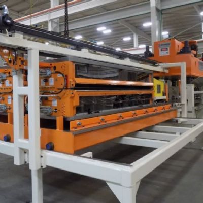

As part of the line’s automation capabilities, the Dallas SyncLoop technology provides monitoring of average line speed and loop depths, and then automatically adjusts payout speed to ensure a smooth payout. To enable quick and repeatable setups, the line includes Dallas’ AutoSet technology, which allows for automatic positioning of some or all of the adjustable points on the feed line—such as straightener rolls, edge guides, coil guides and feed passline--based on job parameters.
The line is built on an Allen-Bradley, Ethernet-based control architecture and features ProfileSelect, a unique and exclusive feed-control system that uses a cam-motion (sinusoidal) profile. This smooth profile results in a feed motion that utilizes 100 percent of the press-feed window, reducing stress on the workpiece material and on the feed’s mechanical components.
