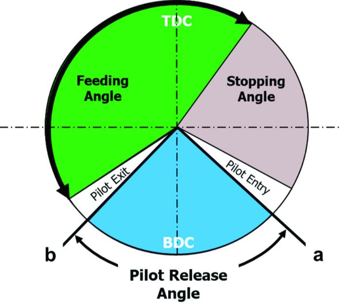

Fig.-1-Feed-roll-lift-closure-timing-Tooling-By-Design-UlintzSetting the feed-release function can be challenging but its accuracy is critical for successful progressive-die stamping. The feed release, also called pilot release, allows the pilots in the die to position and register the strip accurately in the die. For the pilots to position the strip, the upper feed roll must open (lift) just after the tip of the pilot enters the strip. If the feed roll opens too early, the strip could pull out of position from the weight of the material in the slack loop between the feed and straightener or uncoiler.

After the coil stock has moved to its predetermined progression, the upper feed roll lifts (Fig. 1a) to provide sufficient clearance for the strip to be positioned by the pilot pins. Roll lift should occur after the tip of the pilot punch descends deep enough into the material to prevent the strip from slipping backward, but before the full diameter of the pilot has entered the pilot hole.
At the end of the angle, the feed roll closes (Fig. 1b) to grip the coil for the next feed cycle. The combined feed-roll opening and closing sequence is referred to as the pilot-release angle. Should the feed roll close too soon, feed length may appear to be too long. This is true with progressive dies that require long stock-lifter travel to clear working stations in the die. The downward travel of the strip during die closure pulls additional coil stock through the feed unit while the feed roll is lifted. If the feed roll closes before the stock lifters return to their full up position, this extra material becomes trapped between the die and feed.

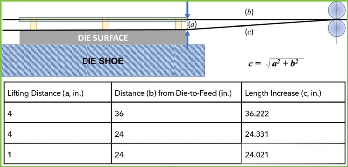

Fig.-2-die-feed-distance-strp-lifting-pitch-length-tooling-By-Design-UlintzWhere in the press stroke the feed closure occurs depends on the die feed height. For dies with little or no strip lift, the feed roll can close after the pilots fully engage with the stripper, holding the strip securely against the lower die to prevent movement. This usually occurs near bottom dead center (BDC), or 180 deg. of rotation.
To clear formed features and other obstructions in the die, some dies require the strip to lift several inches off of the die before the strip can feed forward. In these cases, the closure timing must occur later in the press cycle.
Fig. 2 illustrates the effects of feed-location and strip-lifting distance on pitch length. When the feed rolls close at BDC for a die positioned 36 in. from the feed unit with 4-in. of stock-lifter travel, an additional 0.222 in. of material will pull through the feed as the die closes (distance c in Fig. 2). The table illustrates how this value changes based on feed-location distance and stock-lifter travel.
Should the feed roll (or gripper) close at BDC, the extra material becomes trapped between the die and feeder. When the pilots exit the strip, the trapped material relaxes and pushes the strip forward in the die. The feed then moves the coil to its next progression, resulting in an excessively long strip progression. Incorrect identification of the problem may lead to the press operator changing the programmed feed length to compensate for the timing error.
