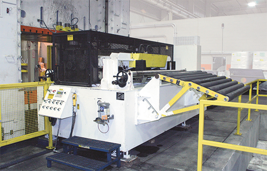

To equip its blanking department to handle 72-in.-wide coils of high-strength steel as thick as 0.400 in. thick, Voss Clark sought a coil feeder that could stand up to the rigorous task at hand. Called to action: a four-roll servo feeder from Cooper-Weymouth Peterson. |

To equip the blanking department to handle the wide coils of high-strength steel from 0.050- to 0.400 in. thick, a multi-disciplinary team at Voss Clark repurposed an existing single-mandrel uncoiler capable of handling 80,000-lb. coils. The team then sent out a call for a shape-correction leveler (a Herr-Voss model) and a heavy-duty press (the firm rebuilt a 1000-ton Clearing). Then it sought a coil feeder that could stand up to the rigorous task at hand. Called to action: a four-roll servo feeder from Cooper-Weymouth Peterson (CWP), Clinton, ME.

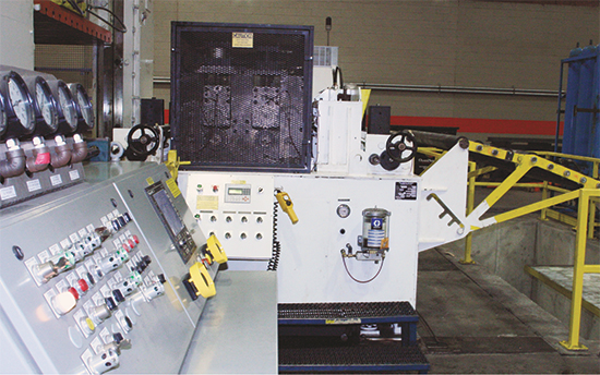

The blanking-line operator control panel controls the press, die clamps, scrap conveyors, loop pit table, light curtains and some features of the leveler. It also displays the various pneumatic and oil pressures. |

The Clearing press boasts a 72- by 108-in. bed and was upgraded with new Wintriss controls and Shadow light curtains. A new Allen-Bradley PowerFlex 700 AC variable-speed drive enables the press to run at variable stroke speeds. “Troubleshooting is simplified by having Allen-Bradley/Rockwell Automation controls oversee operation of the entire blanking line,” adds Marko.

“Its dual feed-roll setup and anti-backup rolls do a great job of holding the material on every stroke, optimizing progression control and accuracy and preventing the material from backing up,” he says. “The AC drive also helps tighten progression tolerances, by providing better feedback to the drive system. Backed-up feed rolls prevent roll deflection, which we find particularly useful when processing thicker steels. And, the unit’s heavy-duty entry and exit adjustable edge guides allow us to guide the material without having to use tooling to guide the material. Most of the tools we run are pilotless.”
The feed line also includes an adjustable-height cabinet base with powered clamps, which allows for quick pass-line height adjustments during changeovers. “That feature fits right in with our quick-die-change initiatives,” says Marko.
