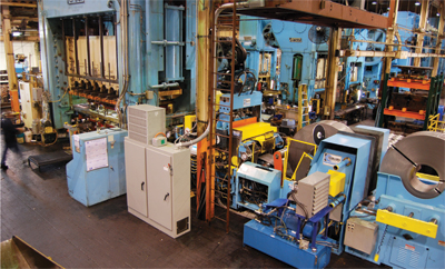

Stamco's new coil line
Stamco’s new coil line, which requires only 17.5 ft. of floor space, feeds a 3000-ton Verson press with HSLA steel to 3⁄8 in. thick and 36 in. wide.

“That’s when things started to not run so smoothly,” says Nieberding. “Our existing feed system, with pneumatic pinch rolls and a 40-hp drive, struggled to pull the 80,000-psi material. We experienced excessive wear and tear on the equipment, side guides were destroyed and the system could not dekink the trailing edge of the coiled material. This resulted in downtime with each coil of steel, as operators cut the end off with nibblers, a slow and hazardous operation.
“Yet, one of the most troubling aspects of the feed system,” Nieberding continues, “was its serviceability—admittedly we push our systems to their limits, and with the grueling work load we put on the rollers, the bearings needed replacement all too frequently. This process took as long as a week to complete, to remove the straightener head, disassemble the components and replace the bearings.”

Stamco’s new Dallas coil line features a hydraulically operated de-kinking mechanism to remove the trailing-end wrap bend of the coil ID, allowing Stamco to optimize material use. It also eliminates the need to manually cut the ends, and the associated risks. A coil stop, peeler and threading-assist assembly also are incorporated into the dekinking mechanism.
A single, 125-hp motor drives all of the equipment, and a chain drive connects to the cradle’s nest rollers to power the cluster-gear-driven straightening rolls, along with the feed rolls. The one drive motor ultimately synchronizes the entire system—there’s no need for material payout loops, which helps to minimize system length.
The cradle-straightener can handle 30,000-lb. coils, 10 to 36 in. wide, to 72-in. OD. Maximum stock thickness is 3⁄8 in. for 80,000-psi steel. At a 12-in. feed length and 240-deg. press-feed cycle, the unit can support press speeds to 25 strokes/min.
The feeder-straightener unit attaches to the main cradle base and includes a ±5-in. motorized passline-height adjustment, motorized adjustment of the straightening rolls, automatic lubrication and memory for storing job-setup parameter. The straightener incorporates nine 5.5-in.-dia. hardened and ground rolls, mounted using anti-friction bearings. The servo-controlled feed rolls are 8-in. dia. and hardened, ground and with a matte-chrome finish for prolonged life. The drive motor is a variable-speed AC vector-type system that allows smooth transitions in feed lengths from 0 to 99.999 in. in 0.001-in. increments.

“Factors that led to the decision included serviceability features we requested be included in the design, based on our previous experiences. These features include easy access to components, including guarded-drive linkages outside the main framework, as well as cartridge-style roller-bearing inserts that simplify bearing replacement,” Nieberding notes. “Now, a bearing changeover, even a roller changeout, takes only a day or less, not the week of downtime we used to experience.
“Also, the length of the new line requires only 17.5 ft. of floor space as compared to nearly 23 ft. for comparable units from other suppliers,” he continues. “With limited space restrictions and accounting for the path of the coil-shuttle car, this was critical.”
The cradle’s powered side guides and integral antifriction roller bearings allow Stamco technicians to adjust the guides by as much as 2 in. in either side-to-side direction. This action permits compensation for most conditions of coil camber and helps align the material to the centerlines of the straightener and feed units. Previously, Stamco could not thread coils received with excessive camber into the existing feed line, and therefore the firm had to reject as much as five percent of incoming coils, creating downtime as stock needed to be rewound, rebanded and a fork truck sent in to remove the coil from the cradle.
The new unit also features an automatic pilot-pin release mode, allowing precision die-actuated positioning of stock. The release operation raises the entire bank of straightening rolls and pinch rolls plus feed rolls, removing tension on the stock so that the material is free to move via location pins in the tooling. Then, too, the straightener head is returned into its normal operating position after the release cycle utilizing as much as 1500 lb. of hydraulic pressure to assure repeatable, accurate straightening performance. The release operation also aides in initial threading procedures of a new coil’s leading edge.
