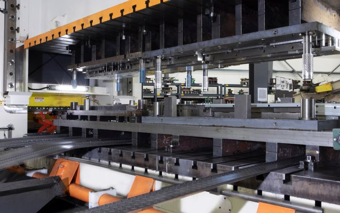

Contributing here is the addition of the Coe WorkRoll Advisor tool, which automatically calculates the required straightener-roll depth based on workpiece-material type, thickness, width and yield strength—parameters entered into the line-control HMI by the operator. Then, the settings can be saved into the straightener’s job-recipe manager for quick recall the next time that material runs. Then, during production, Coe’s Work Roll Compensation feature monitors the coil OD and automatically adjusts the straightener to compensate for changes in coil set.
“In addition,” says Axelberg, “our tool-development team continues to learn how to take advantage of the different stroke profiles that we can program into the servo press. As an example, consider a high-volume bracket that we stamp for a solar customer, from 5⁄16-in. Grade 80 steel.
“The part has four slots stamped into it, measuring 0.709 by 2.48 in.,” Axelberg continues. “We machined a rooftop shear profile into the punches to keep the tonnage down, but stamping the parts on a conventional 800-ton mechanical press caused intermittent clearance burrs. When we moved the job to the servo press and developed a link-motion stroke profile, we completely eliminated the issue.”

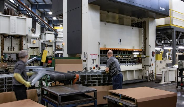

The centerpiece of the GSM pressroom is its new servomechanical press, a Seyi 660-ton model SDG2-660-S-5, outfitted with a 54-in. Coe feed line equipped with WorkRoll Advisor software. Industrial equipment supplier Press Automation Inc., Elkhart, IN, supplied GSM with the line. The devil is in the details: Press Specs Tonnage: 660 tons Stroke: 14.2 in. Die height: 34.25 in. Windows: 51 in. Slide adjustment: 10 in. Bed size: 145 by 61 in. Feed Line Includes dual threading table, and Coe 507 HD-series heavy-duty straightener Coil width capacity: 54 in. Max. feed length: 35 in. Sheet-thickness capacity: 0.62 in.; 3⁄8 in. at 24 in. wide Max Roll Speed: 319 ft./min. |
