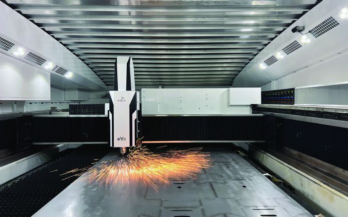

Of course, says Watkins, cutting with 20 kW of power can be a double-edged sword, as the ability to cut ½-in.-thick mild steel (for example) at more than 300 in./min., and 16-gauge sheet at 2100 in./min. can push a lot of material onto downstream punching machines and press brakes. Ah, but here we find additional capital investments at BOM to relieve any bottlenecking, such as new servo-electric press brakes, large-capacity hydraulic press brakes, and updating existing press brakes with new controls and six-axis backgauges. “And, we’re looking to soon bring in robots to help support our press brake operations,” Watkins says.

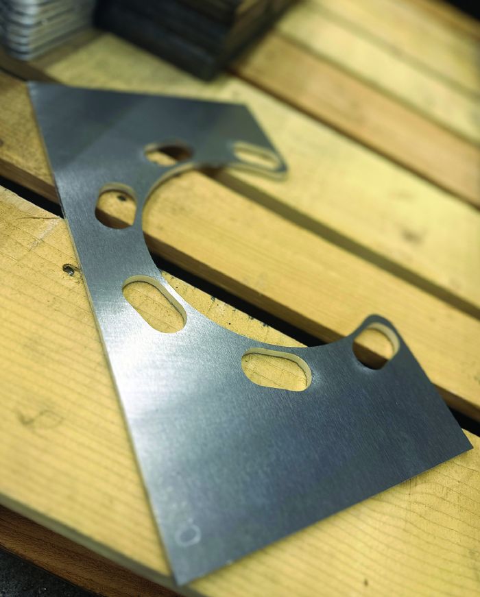

Watkins finds that the 20-kW machines fly through ½-in.-thick steel and cut up to ¾ in. really well, and that 1-in.-thick plate is at the top end of the machines’ capabilities. A nitrogen-oxygen assist-gas mix (2.5% O2) optimizes cut quality on thicker material, reducing or eliminating any burr formation on the work.
“And, that assist-gas mix also prevents case hardening of the plate edges,” Watkins says, “so that we, or our customers, can tap holes at a less than 1:1 ratio of hole diameter to plate thickness (a ¼-in. hole in 3/4-in. plate, for example). We’ve had customers tell us that some of their other suppliers, cutting with 100% oxygen assist, provided laser-cut blanks and parts that had been edge-hardened to the point where they’d break taps.”

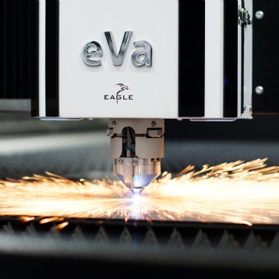

One might express some concern, when laser cutting at such high speeds, regarding the durability of the cutting head. However, as Watkins explains, Eagle’s cutting-head design locates the cover glass very far from the nozzle, “13 in. away, while more commonly we see laser cutting heads with the cover glass only 4 to 4.5 in. away,” he notes. “That added distance helps to keep the cover glass free from contamination, particularly important when cutting pickled and oiled (P&O) steel, a big runner for us. Less lens contamination means less maintenance; compared to our previous 4-kW cutting machine, the cover glass on the Eagle machines last as much as 90 times longer when cutting P&O material.”
Per Eagle, its patented eVa cutting head provides automatic beam centering and minimal service requirements, among other unique features. For example, company officials note that the head comprises only three wearing parts: the cover slide, cover slide seal and cutting nozzle. Anti-collision protection is delivered in four levels:
- A capacitive nozzle sensor avoids low-speed collisions.
- During cutting, the head can slide to the side, giving the machine time to stop.
- In the event of a high-speed impact, the cutting head will rotate on springs, protecting the lower module.
- The lower module breaks off at full traversing speed (more than 100 m/min.) in order to avoid serious damage to the machine. After such an event, returning the machine to service only requires the installation of a new centering module.

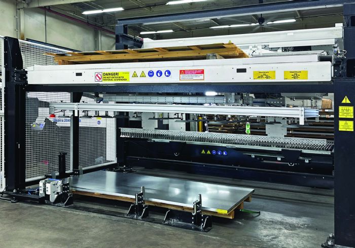

… in the fabrication department at Big O Metals? For starters, Watkins looks forward to adding automation to his laser cutting machines, to further increase overall equipment effectiveness and enable lights-out cutting.
