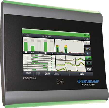

As an example, at FABTECH Marposs demonstrated for MetalForming the Brankamp X series of real-time process monitoring technologies for metal forming and stamping operations. The units immediately identify manufacturing faults as well as part or tool variations, with stated benefits including optimized machine efficiency, improved part quality, and the potential to limit unplanned downtime and tooling costs.

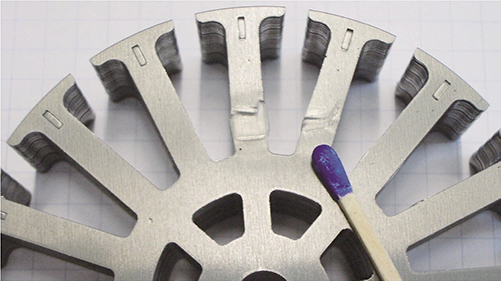

An errant slug, a blob of oil…the slightest problems in a die can spell doom for intricate, small parts. The ability to detect and act upon such problems quickly saves tooling and minimizes the chances of producing bad parts. |
Depending on the application, sensors placed either on the machine, in the tooling or in the dies connect the press to a Brankamp X-series unit, enabling users to assess in real time process performance via an HMI.
Force sensors, placed in specific positions, monitor tool and machine performance related to the forces applied, according to Marposs officials. From these sensors, the systems learn the normal limits of the process. The control unit then observes the signals of each cycle and compares it with the stored limit curve. Sensing the movement of a signal outside of the envelope curve, the formed part is sorted out or the machine is stopped.
