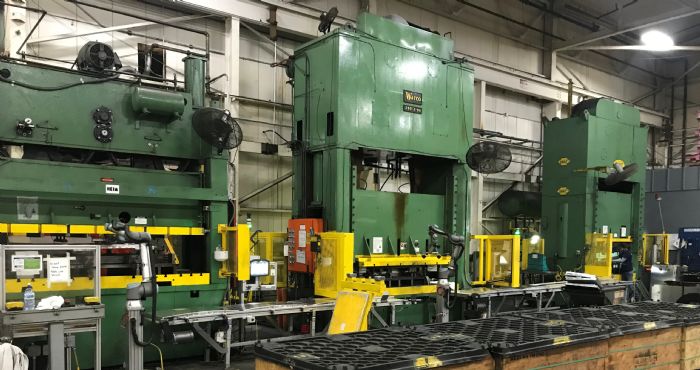

Presses, Cobots, Conveyors Intertwined

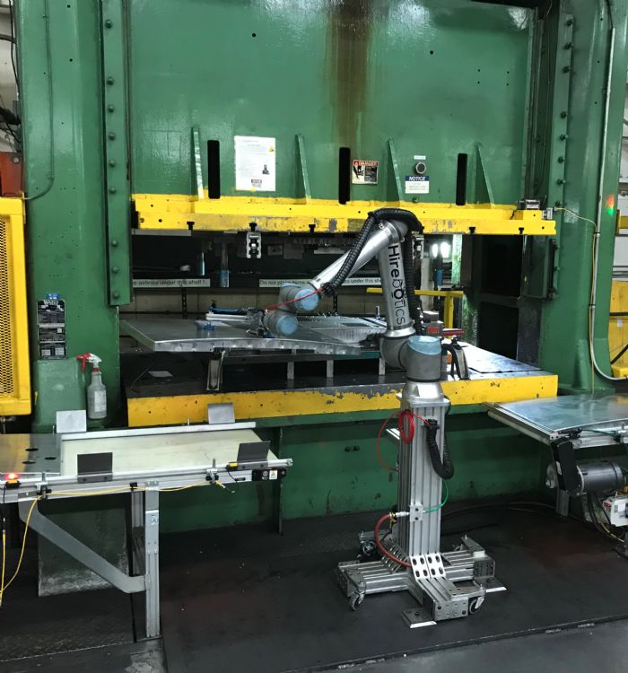

As mentioned, the cobots tend two presses in this operation, with the initial forming press tended by hand.
“An operator tends the first coil-fed press, which stamps the initial blanks,” Larson says. “The operator stacks those blanks on a pallet for transfer to the next press, where the operator then forms the part and places the formed part onto a conveyor for pickup by the first cobot. We would use a cobot for this work, but it’s too difficult to separate the oil-coated aluminum blanks. With steel, we could use magnets for separation.”

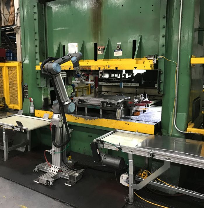

After initial part blanking and transfer of those parts to the conveyor, the two fixed-location cobots pick the parts off and place them in the dies of their respective presses, then unload the formed parts onto conveyors for continued travel down the line. On the conveyors, parts funnel down to sensors that stop the conveyors when parts reach their required location. Conveyor sideguides ensure proper part orientation for cobot pickup. Complete cycle time from pick to placement in the die to unloading of a part back on the conveyor is 24 sec.
“That’s slower than a human, but then again, the cobots are always on station (across PMI’s two-shift Monday-through-Thursday  operations and single-shift Friday-through-Sunday work),” Larson says.
Hirebotics integrated the conveyors into cobot programming, with PMI integrating the cobot controls into the press controls, according to Larson. Essentially, a cobot runs each press, with sensors on the conveyors communicating part presence to the cobots, which then know to pick up the part. A conveyor will not move until a part is picked up, and a cobot will idle until the conveyor presents a part for pickup.
With a new part placed in the die, the press will know to cycle.

As mentioned, two part types run through this line, but despite similar dimensions they each require unique tooling. The permanent pre-positioned cobot baseplates ease the die-change process, as the cobots quickly can be removed for press-bed access and pinned and bolted back to their correct positions after tooling install.
