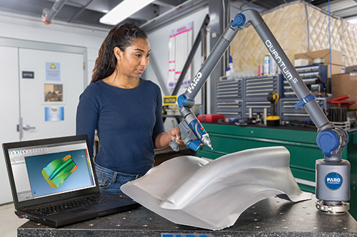

Production volume, a major benefit of metal stamping, enables efficient production that delivers parts in a short time frame as compared to other processes. The ability to provide quality measurements inline or close to the production process enhances that benefit, making portable CMM arms ideal in stamping operations, according to Green.
“A portable CMM arm can be taken to the line or nearby to scan a part every minute or two as a check to see if something is wrong,” he explains, noting that an automotive A-frame pillar can be scanned in about 1 minute, with perhaps another minute for data to run through the automated inspection program, yielding a 100-percent inspected part with statistical process control for every feature and every data point. “If so, the part can get a closer look at the fixed CMM. With the arm, instead of blocking and fixturing the part for a fixed-CMM scan, a user just sets it on a flat and stable surface for scanning in a fraction of the amount of time and pick up any surface deviations.”

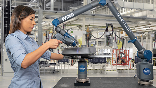

“Any shop-floor use exposes the arms to environmental variables not experienced in a controlled quality-lab environment,” Green says. “Dust, humidity, temperature fluctuations and more are common on the shop floor, but the arms are built to handle that. For example, they contain temperature sensors in all axes that compensate for thermal expansion and contraction of internal components. For extreme changes, say where a bay door opens and brings in 30 F air, the Faro system in particular will alert the user that the portable CMM arm cannot compensate quickly enough for the temperature change and provide two options: continue measurements―okay for loose-tolerance parts or weldments―or wait for temperature normalization―for aerospace flight-safety components featuring tight tolerances, for example.”
And, Green says, “Faro’s newest Quantum arms are ISO-certified for contact and noncontact inspection, a rigorous analysis of how accurate a machine is in the real world. In addition, all of our arms are vibration- and drop-tested to military specifications.”
