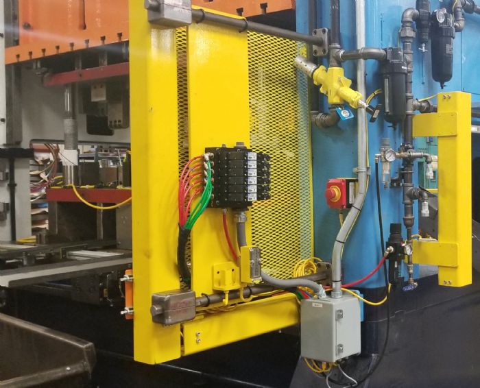

Employing multiple sensor types from multiple companies—listing Balluff, Banner and Turck as the companies supplying the most product at Omni Manufacturing—Prater identifies inductive proximity sensors as the most common, with through-beam sensors also employed in areas where they can be shielded from dirt and lubricant mist.
“We had problems with a laser sensor shooting down from the top of the die,” he recalls, attributing challenges resulting from oil fogging the laser path. “At FABTECH one year, I talked to a sensor vendor about what we were trying to accomplish on that die. He told me that he didn’t have a sensor to do what I wanted, but instead had a solution to the problem: an inexpensive product typically used in weld systems that creates a vortex of air to keep the laser path clear. It worked.”
Using that example, Prater recommends talking to experts at shows and conferences, who may offer unique and helpful advice.
“You go out looking for one thing, and may find that you don't really need to change sensors,” he offers. “You just need to change your approach.”
Tame the Torque and Simplify Connections
For inductive proximity sensors using nuts and threads for install, Prater offers some advice based on experiences at Omni Manufacturing, noting that sometimes their install results in over-torquing the nut, which damages the sensor.
“Instead, if installing a 12-mm sensor, for example, we would drill a 12-mm hole and clamp the sensor in place rather than use the nuts for tightening,” he explains. “Depending on the sensor, changeout may cost $40-$50 per sensor plus downtime. That’s a couple hundred bucks just because someone applied excessive torque.
“Also,” he continues, “an installer may employ set screws tightened against the sensor barrel to hold it in place. Excess tightening causes damage as well. Clamping fixes that problem.”
Adhering to the KISS principle, to ease die changeover Omni Manufacturing routes all progressive-die sensors to a single junction box, with a cable running back to the press controls. The cable plugs in and all die-protection parameters are recognized—a plug-and-play setup. At any press, the control will recognize the sensing for a particular die. The newer press controls, notes Prater, make this capability much easier to implement.
