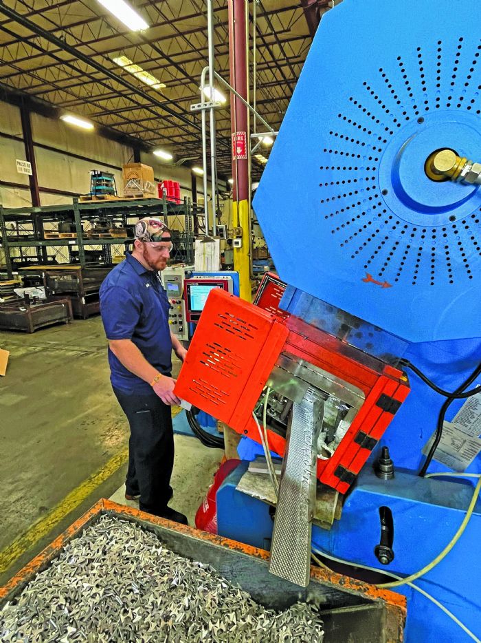

“We developed the tool design inhouse and had it built at a local die shop,” Wyan explains. “We can use the tool to stamp blanks for several different part numbers, some of them specialty washers. The blanks then move to our coining presses to form the unique features that our customers specify.”
Coil-fed (from a Universal Feed coil line, formerly Feed Lease), the new press processes aluminum grades as well as three grades of carbon steel, from strip 4 in. wide and narrower. Feed length is automated through the part program on the press control. The die also is equipped with in-die sensors to detect part-out and double-sheets (a slug or if a portion of the tool fails).
“Honestly, it’s a slick tool design,” Wyan says, “that allows the press operator to not only change the tooling at the press, but should he need to take it out of the press to perform additional servicing, it’s only four bolts on the bottom and four bolts on the top. And, it’s small enough so that one person can load it onto a die cart and work on it, enabling fast changeover.”

How much faster can the firm run legacy tools on the new press? “It maxes out at 200 strokes/min.,” Wyan says, “when we use the shortest stroke. Even on a one-out tool at 200 strokes/min., we can produce more than a two-out die running on a conventional press at 70 strokes/min.”
Stroke, set manually by the press operator following job-router instructions, ranges from 12 to 110 mm.

Wyan and Childers have found the press to fit perfectly into the facility’s drive to become lean, as it’s been busy conducting lean training for its associates, including instruction on quick die change. Along with staging dies and material for subsequent jobs in the queue and equipping die carts with all of the tools needed for changeovers, the firm has prepared work instructions for changeovers. Changing out the 200-lb. die that runs on the Sangiacomo, “we can place the die in the press, set it up and have it running in 20 min.,” Wyan says.
“It’s a fun press to run,” he adds, “and we even can adjust the speed of the press while it runs, which proves helpful when we’re trialing new dies. We can start at 80 strokes/min., for example, then bump it up to 85 or 90 and watch how it runs, then ramp it up to 120 or 140 strokes/min., then adjust it back down if we need to, should part-quality issues arise. However, oftentimes the faster we run the cleaner the cut when we’re blanking. We’re within 0.001-in. repeatability with this press; the precision is there.” MF
