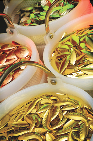

Part runs to 500,000 on Worth’s 88-ton-press lines produce a variety of angling components, including various blades for fishing lures. For more than 70 years the company has supplied fishing-lure makers with components.
